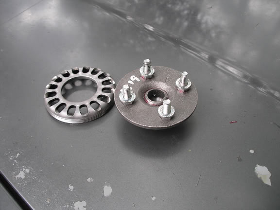

I couldn't find a low range inch pounds torque wrench anywhere locally. I ordered one online.
I thought someone here might be interested in seeing my custom carrier bearing torque tool, see pics. Cost me about $4.00. It fits perfect, the nut threads even "snap" into place.
