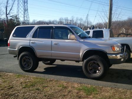

Update: I threw one of my old axle shafts in there and it stopped the wobble. I also swapped the front diff with a 4.30 as well. So all is good. Only issues is that I need to replace all the hardware on that axle shaft and my rear diff still leaks. Also the front diff drain plug is stuck and rounded out. Not too bad. Anyway, here are some pictures.
