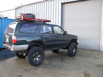

Well the Punisher has finally come to life just in time for the snowy trip up to Portland, Oregon from Santa Cruz, CA. tonight.
Finally got the sonoran steel 1.2 kit installed Saturday along with cryo'd 5.29 yukon gear sets. I love it. The power and torque feel so much better than the 4.10's with 33's. The 2.7L is not the most powerful motor. The 3" body lift was on it when I bought it. So I just left it in.
Went to install the wheel spacers and noticed the threads do not come all the way through the supplied lug nut. is that normal? I seriously do not want those coming off on the highway! I got them from WABFAB. 1.25" thickness.
I mounted up my 35X12.50 Trxus MT's on 17" wheels without the spacers. The wheels have 4" backspace and I do get frame rub at full lock, but very minor. So with the 1.25" wheel spacers it should alleviate that problem. Though I may return them for 1" instead.
All that is left is the ARB for the rear and some trimming of the front pinch welds and fenders. Then install the stubbs sliders once I get them powdercoated.
Attached Thumbnails The Punishers New Meats-spacer.jpg   The Punishers New Meats-ss1.2-35s.jpg   The Punishers New Meats-ss-1.2-33s.jpg
