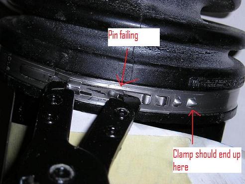

Hi,
I have a 98 tacoma and I'm replacing the CV boots. I had never done this before so I read many writeups here and other places and I have the FSM. I purchased the Toyota boot kits.
I'm almost done but I can't get the large inboard clamp (on the tulip) to close. I don't see how Toyota or Toyotas techs can get this to close, it's not even close unless I'm really doing something boneheaded. This is the only one that is not an "ear" style - you simply close it until a pin snaps into a hole. I'm using a pliers type tool which I suspect is not the right way to do it.
I tried to increase the force by using large conventional pliers to add force to the clamp tool and the CV boot clamp will fail before I get close to closing it far enough (see pic). In fact, I don't think the clamp can even close by this method since the holes for the tool will almost overlap.
I have seen where people use zip ties or hose clamps but I hate to do that. Assuming I'm not doing something wrong would a parts store like NAPA carry an ear style replacement clamp?
Thanks
Attached Thumbnails Problems with CV boot clamp-pliers.jpg   Problems with CV boot clamp-pliers2.jpg

Someone told me that you just use channel lock pliers around the body of the clamp.
The way I was doing it with those pincer type pliers does not work (obviously) on this type of clamp.

i never have good luck with those style of boots, i always use the foldover style.....
But i do believe that the only way i have ever seen these style put on are with the special tool (ford is a little differant style but would work the same) it hooks to the peice to the left of the "failing peice" and goes all the way around then uses leverage to force the teeth on the lower peice of the clamp together.....so maybe if you could figure something out to wrap the whole thing and get it really tight....that doesnt look nearly tight enough
