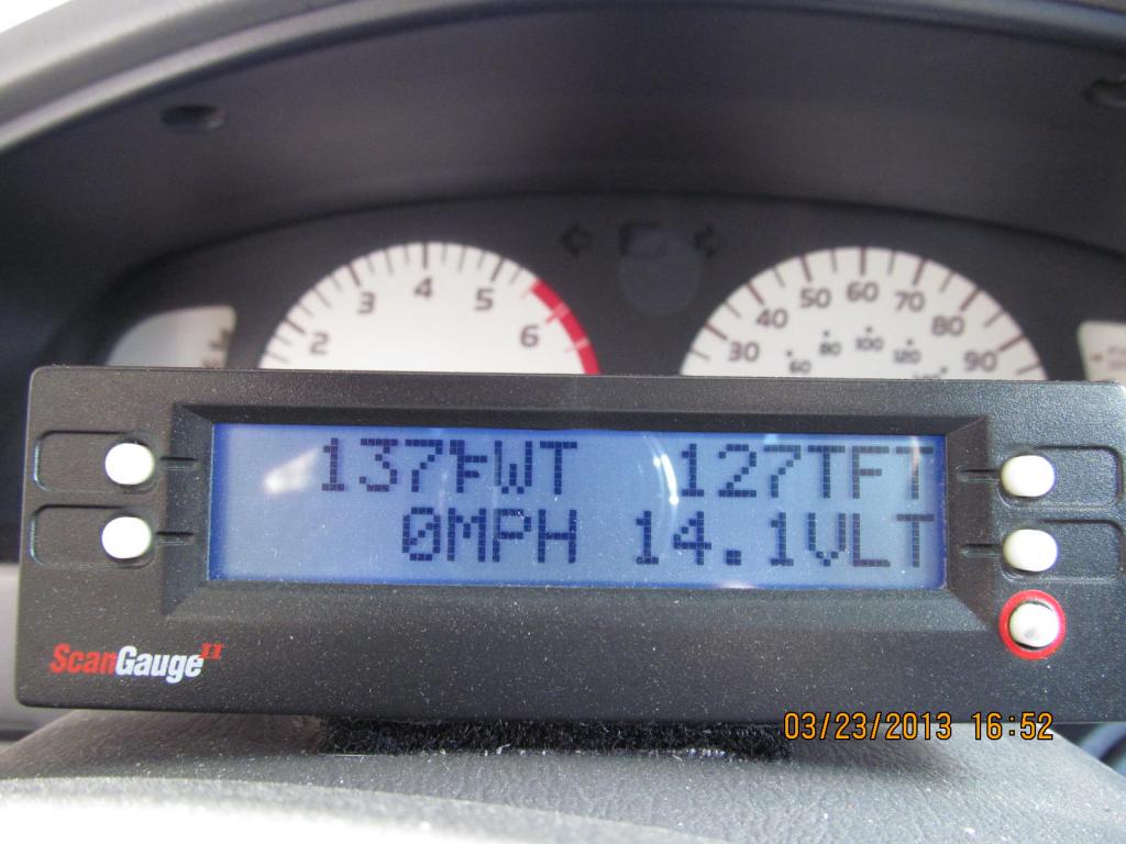

One of these would allow you to monitor tranny output temps and you would know before the fluid changed color....not every year of Runner/Tacoma has the "TFT" tranny fluid temperature. I had to search the boards to find the code to enter. The water temp and tranny temp are the most valuable to me. If you know anything about your oem water temp "gauge" then you know it's anything but a gauge.
