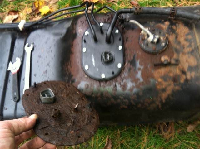

I wanted to post an update. I replaced the fuel pump mount and the gas smell is gone and mpgs are up. Complete pita if done on a residential street. possible evap problem or fuel injector ????-fjnvf.jpg but it still runs rough.

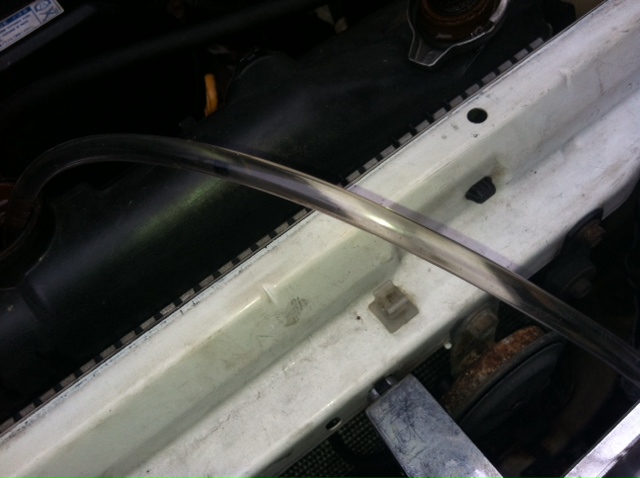

About 2 or 3 weeks ago I hopped out of my car on a cold start to get something out of the back and almost lost my mind when I saw a little puff of white smoke and moisture dripping from the pipe. The smoke only shows up on a cold start and lasts about 3 minutes then gone. It's never that much either, just a little. I ran a compression test, all cylinders hit between high 140s and high 150s. No real big dips there. I checked my oil: clean. I leave my scanner on drives and the ect always runs between 181 and maxes at 185 but mostly sits at 183. Coolant level has never dropped. Siphoned some out, here are the results: possible evap problem or fuel injector ????-oq54o.jpg
I read that moisture can seep into an exhaust leak and thats what I think I have. I ran seafoam through the booster line and found no smoke under the hood.
Here are the symptoms: runs a little rough all of the time but around 2500 in any gear it feels like it's maxing out and it sounds like its winding really tight. I can push it to 3 but I dont like to. Another important thing I remembered is that when all of this started is that my post cat flange gasket blew and later my post cat 02 sensor had a heater malfunction.
So here's my question. Could my muffler be frakked? Would that cause poor performance? It's definitely louder than it was before. Or does this sound like a manifold leak/crack? What should my next step be?
Thanks for all of the help so far.

-Back to your fuel pressure regulator issue, if you don't have vacuum to it, you should check the metal tube that the vacuum line connects to. they can rust from the inside out like clogged arteries. But that shouldn't cause your symptoms.
-Some smoke and moisture out of the exhaust on a cold start is normal. Condensation can form in the exhaust as it cools off and then burn out when you start it next.
-If you have no codes, and data looks ok, you might have a restricted exhaust. Get a friend to rev it a little and see how much flow is coming out the tail pipe. You can hold a folded up rag or towel over it and feel the pressure (just don't burn yourself) Compare it to a friends 3.4 that runs good. An exhaust leak won't cause these symptoms but this test can also make a leak easier to find
