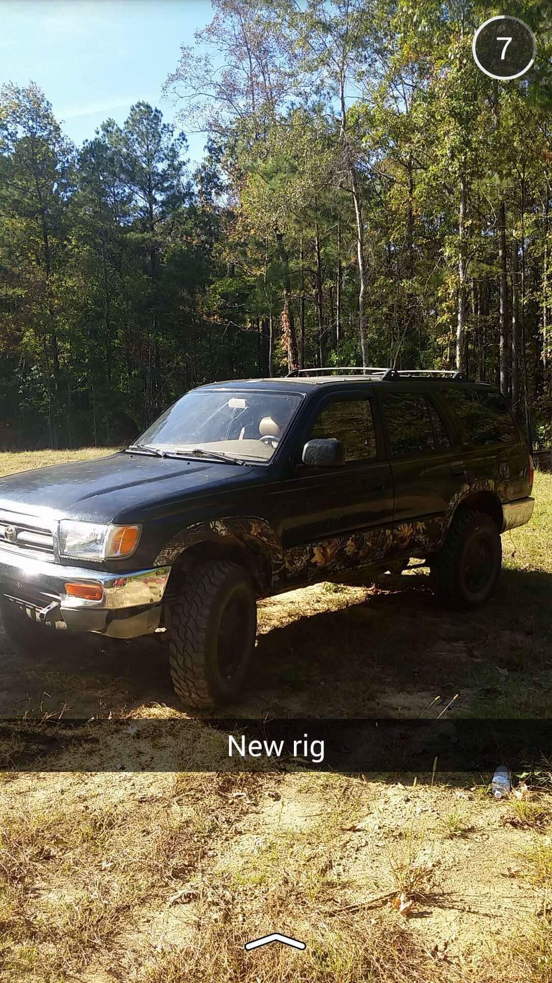

Figured I would show you what she looks like. 151k miles. Whats the best route to go for the fender trim? <br/>

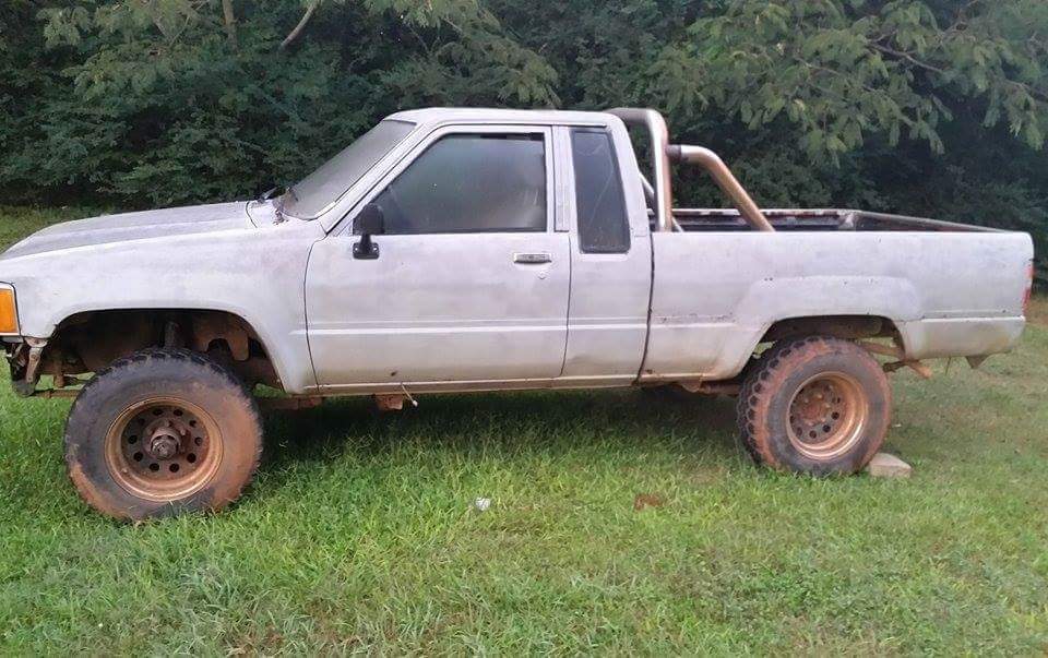

And I just picked up 85 extra cab efi and am really enjoying driving it. Like it alot
