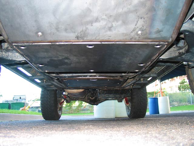

hey all i just got the new ORS skid plates installed yesterday and i must say they are cool, very heavy duty and extremely well made. i will be trail testing them on sunday up at chinaman's gultch so i will let you know how they do but im certain they will work awesome im not sure on the cost so if your intrested give mike at Off Road Solutions a call and he will quote you one on a side note i must say that i believe mike and the whole crew at ors do some of the best work in colorado and i highly recomend them! ill report back after the weekend and let me know if you want me to post some more pics

Can you tell us more details as to what it's made out of, how it connects to the frame, how thick the cheet metal is, if there's anything protruding down, like it looks like some rivets do on the front top, etc? Let us know the details if you can.

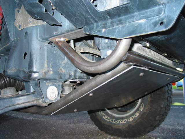

mike and grant used dom tubing for the outside frame but im not sure what size it looks to be about 1.5" and 3/16 plate steele on the bottom and front. it uses all the factory holes to bolt up with. the front cover is removeable and intended as access for oil changes as well as inspection. the rivet looking things are actually allen bolts he went to great lengths to keep every thing nice and tight to the frame so nothing sticks out anywhere note the radiator protection built on to the end. the transfer case skid plate is of a similar design except he used 1/4" plate instead of 3/16 he believed the transfer case needed a little extra! on the front skid there is also some extra bracing just behind the radiator support here is kind of a side shot!

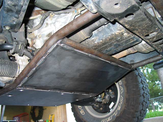

here's a pic from the back side

Man, why the heck did they choose allen keys? I hate them things. I like the design of it, and I was wondering what kinds of supports exist on the top sides of the plates on top of the sheet metal, in the even you hit the center of the plate on a rather small sturdy rock?
The front support look way beafier than any other plate I've seen out there so far. I like that!
Where are the locations of the bolts that secure it to the frame? Do they using a bushing of any sort to prevent metal to metal rubbing?

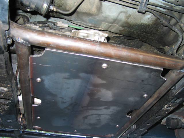

chris i think they used allens so if they get hit with rocks you wont wear off the sides of the bolts with an allen you dont have to worry about that as far at the supprt goes the dom tubing runs along both sides and due to the thicknes of the steel and the short span the result is solid steel across the full width of the plate im pretty sure i can stand the truck on the skidplate alone i will definitely get back to you after the trail test but i dont anticipate any issues here is a pic of the transfer case plate

It looks like the transfer case skid isn't welded to the tubes, but just bolted instead. Is this true?

yes that is correct it would be a major PIA if it wasnt made that way as far as maientence is concerned that way when you have to work on it you dont have to take the whole thing out (it is very heavy about 60# id guess)just unbolt the plate and you are ready to go
