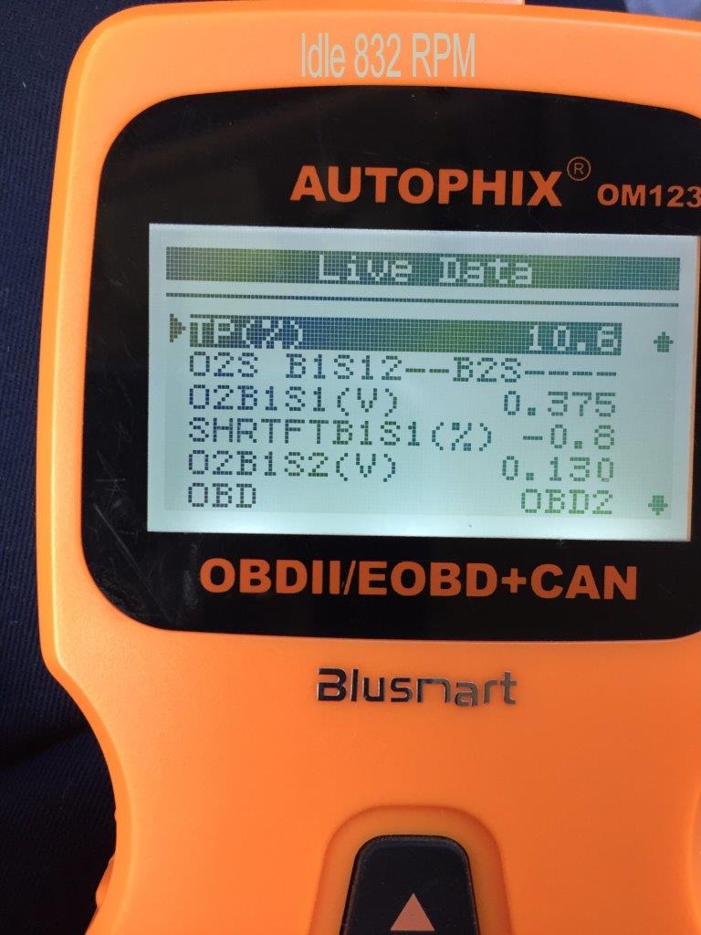

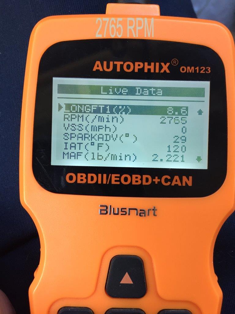

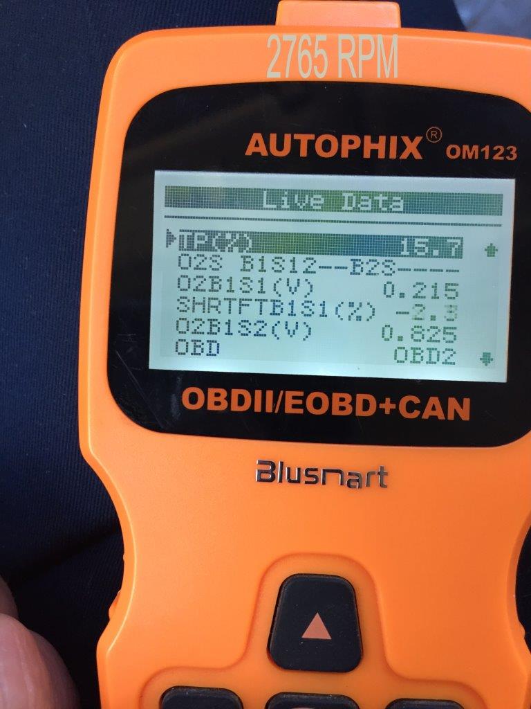

I am having a hard time diagnosing an intermittent P0171 code. I have posted my engine codes from OBDII at idle with A/C on and driving at about 2700 RPM. I am not sure if I have a vacuum leak or a valve is not working correctly. The P0171 code is an intermittent problem, sometime my long fuel trim is at 19.5 and sometimes it is over 30 (when I get the error code) (see pictures). What it the normal reading in the first place? Is 19.5 at idle good or should it be lower? I have (all Denso) changed front O2 and MAF sensors, fuel injectors, plugs and wires. Can't find any vacuum leaks but haven't done a smoke test yet. It does run good still and MPG on Hwy is about 17 to 18 MPG. Does anyone have any ideas? Also, I have 217.000 miles and still love my 4Runner.

How's the idling? Steady or all over the place? I see with a/c, the 832 rpm. When does the code come on? Seems like you've covered many of the common suspects. Can't say about intermittent codes and electrical associations but neither should it be ruled out. If you found a leak on one area, there's prob other places too, so I wonder what you end up finding with that smoke test.

Idle is great and smooth, usually about 700 RPM with A/C off. Code comes on after the thermostat opens, about 5 minutes after I start it. I can clear it and it may or may not come on for a while, all of my trips are usually about 5 to 7 miles at a time which is about 15 to 20 minutes 4 times a day. I drove 220 total miles to see my kids a couple of weeks ago and it only gave the P0171 code when I first got going and again when I was almost back home.
