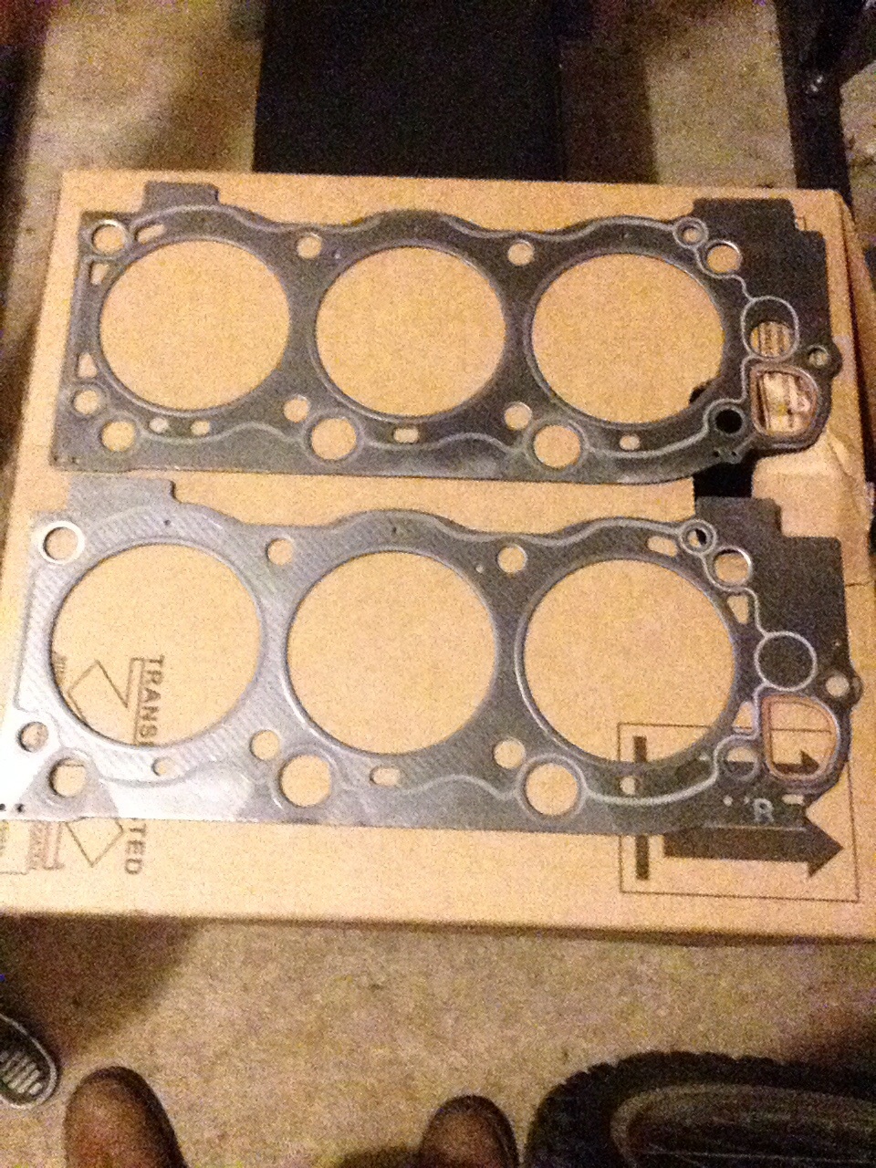

So since this is my first headgasket job I'm understandably nervous about getting it right. I have the oem headgaskets and they are labled L and R. I'm viewing images on the net and imaging how they are installed L is the vehicles left side withe printed side down, R being the opposite, again printed side down. The printed side has the seal applied at the factory as well. The image is how I think the headgaskets should be installed printed side down, l on vehicles left r on vehicles right. This image is from the perspective of being in the cab behind the wheel.

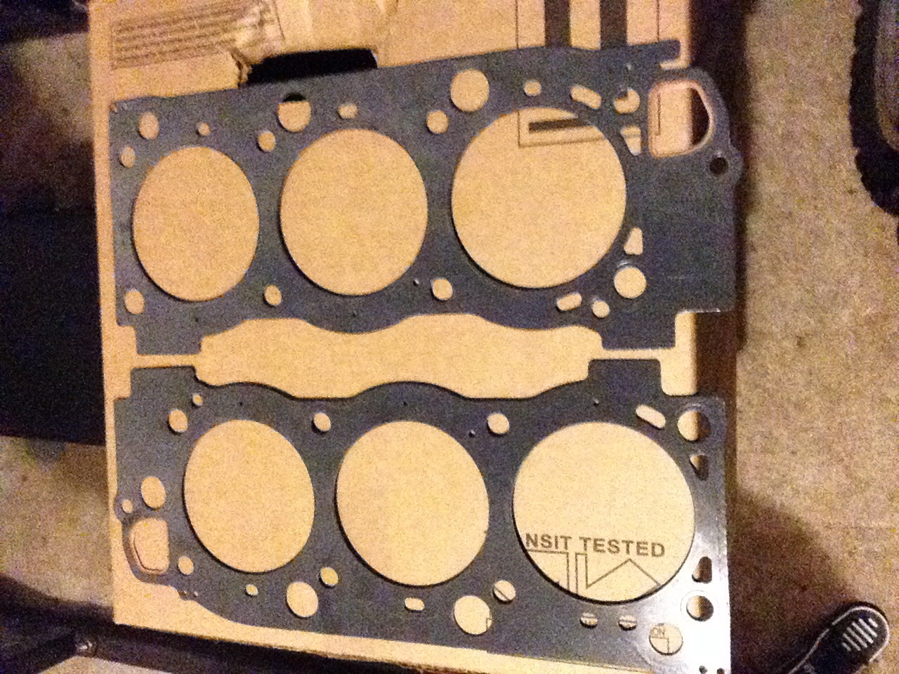

This image shows the packing seal that's pre-apllied at the factory. Mine is damaged, the top gasket, middle cylinder, upper portion of the image you can see the missing portion of seal. I'm taking them back for a replacement. I just wanted to ask, this printed side with the lettering L and R, and the sealing material is the side that goes down, correct?

Just in case some one comes along with a similar issue and views this thread.
Turns out the headgaskets were installed backwards. See the thread titled "1996 unused for 4 years" on tacoma world for pictures of the old head gasket incorrectly installed compared to the correct oem headgasket.
The left and right sides are nearly identical, except for one nickel sized port on the left head that is absent on the right. Mine were installed with the port blocked due to the right head gasket being placed on the left head.
