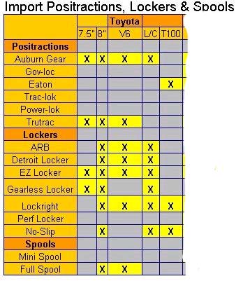

From Randy's Ring and Pinion Website- what's available for the Toyota V6 (chart unfortunately doesn't go into much detail, but gives you an idea of whats out there):

just so i know when i get a 4x4 third gen... the front is a 7.5" right? according to that chart, there isnt a selectable locker for the front... is this true?
Old Jul 22, 2003 | 01:28 PM
Mad Chemist's Avatar
Joined: Feb 2003
Posts: 2,858
From: Seattle, WA
Well, I think so. Honestly, I don't know of many (actually, any) 3rd gens locked both front and rear. There is a huge gain with the rear locked in offroad ability, and a smaller gain by the front being locked (in addition to the rear). I've thought about going to a limited slip differential in the front. But, again, I don't know of any 3rd gens to be locked in the front, so it'd be breaking new territory (I think?)
