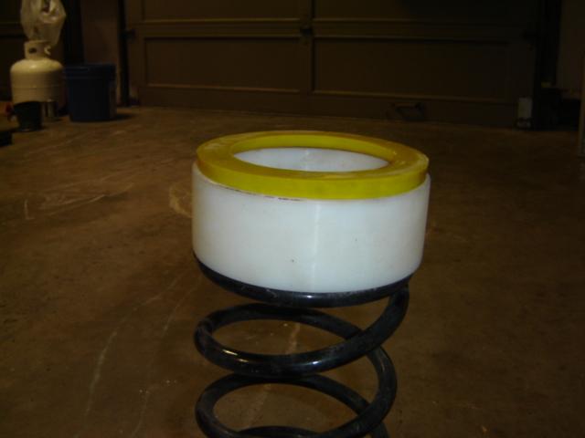

I rolled with the Revtek lift for about a year before the rear started saggin, I only went off road once with the set up, it really put alot of compression on my factory springs. If you do any towing at all I wouldnt use the revtek in the rear, (my) springs couldnt handle the compression and it was to the point that a BIG buddy of mine could bounce on the bumper and hit the bumpstops after about 16k miles with it on. The front spacers however are awsome IMO. I am still running my factory shocks/springs as well no drop at all and still handles the abuse very well. I recently went with the OME rear springs and shocks and the ride is so much better than the revtek gave me.
You would only be able to put the packer on top of the spacer, I think it would have a tendancy to shift since there is nothing to align or hold them other than the small lip round lip at the top where the spring seats and its about as deep as the packer. It all looks pretty shady to me, I wouldnt do it.
