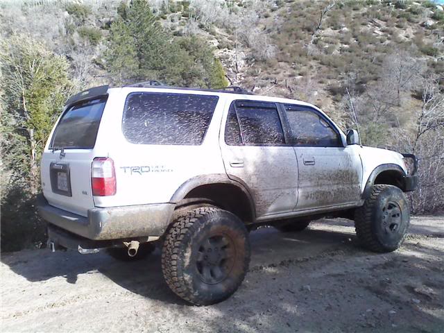

Here's a couple shots of mine with a 3" OME lift and 1" BL:
