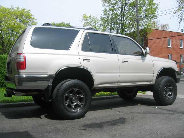

I finally got around to installing the OME lift. The rear was a major PITA. Not hard but the rear shocks gave me fits. I went with OME 882/N91 front and OME 890/N86 rear. Gained approximately 3" at all 4 corners. Here is the obligatory mall crawler shot.

looks great, very nice truck.
did you need anything else? if you don't mind, how much and where did u get it? bigger tires would look better...

I purchased the 882 assembly from a friend in GA who ran them on his Taco. I paid $150 for the front. They were already assembled so it was an easy swap. I purchased the rear lift from Wheeler's offroad (about $330 shipped). I need to do the diff drop but I haven't ordered it yet. I just purchased the Dueller revos (265/75) so it will be awhile on the tires. My plan is to get another set of rims and get some 285's for offroad use.

thanks. and, wow, those are 265/75?! thats the biggest tire i want and this lift makes them look small!

yep, they looked huge before the lift. Once the lift settles I think it will look much better.

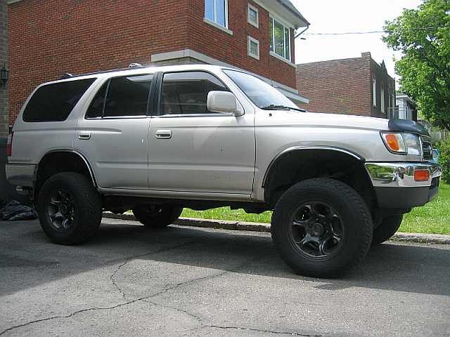

I recommend to installed diff. drop immediately. With 882 on 4R is stressing to much on the cv axle. I'm running a set and I'm thinking which is the best result for front suspension.
Attached Thumbnails OME Lift installed 3rd Gen-picture-1253.jpg   OME Lift installed 3rd Gen-picture-1252.jpg

Got one on the way. The inner CV boots were leaking before the lift and the lift didn't help matters. A couple of hose clamps temporarily fixed the problem. I plan on adding a TJM or ARB in the near future so that was the reasoning behind the 882's. I ran them on my tacoma for 3 years without a problem. hoping to get the same results out of the runner.
