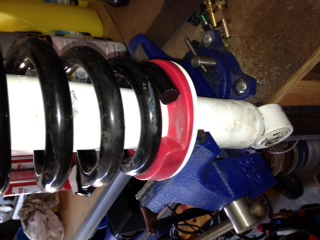

I have just recently installed the 881/890 OME springs with new pro-comp es9000 shocks and struts. When installing them, I made sure the taller rear spring was installed on the driver's side with the shorter one on the passenger. Now that they have settled, it seems I am sitting a half inch low on the driver's side front and rear. It is very obvious from looking at it from the back and would like it fixed and have done some research about the lean and know that it is common. I have an OME 10mm rear coil spring spacer on order for the rear. But, will this help the front at all? I also keep my tank above the half way mark at all times so it will always be leaning without a fix. So, should I get the 1/4 inch front top plate spacer as well?
From the center hub
Driver's Front: 21.5"
Driver's Rear: 22.5"
Passenger Front: 22.0"
Passenger Rear: 23.0"
Attached Thumbnails OME Driver's Side Lean... Best Fix???-photo-1.jpg   OME Driver's Side Lean... Best Fix???-photo-2.jpg   OME Driver's Side Lean... Best Fix???-photo-5.jpg

When I Ordered my OME lift, a Trim packer was included. The small golden ring above the front coils in the picture included. [IMG][/IMG]
It is placed on the strut before the coil.

Alright, looks like I don't need the fat chick after all. LOL I removed the front right strut and as you can see in the pics, it is now seated correctly. And, the truck is now sitting perfectly!!! Guess the front was pushing the opposite side down. Thanks guys.
