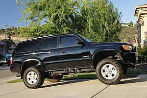

Big thanks to the folks over at toyteclifts.com for talking me through the various options for new coils and shocks for my '02.
And a big thanks to YotaTech for leading me to OME and ToyTech.
I didn't realize how bad my ride had become over the course of 110K miles. Now I'm riding smooth and a bit higher.

Nice looking. It will settle a little. What are those tires?

The tires are Kumho Road Venture MT KL71

The 4runner looks great! I see you have a body lift too...are you running wheel spacers also?

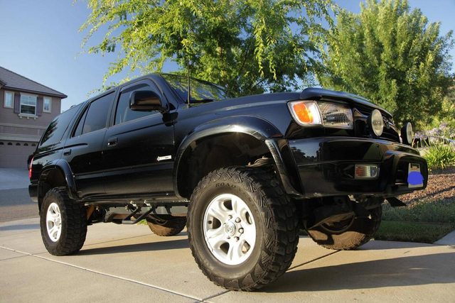

What is that thing hanging off the passenger side?

I think its a step for the women in his life?

Bingo. Too many complaints makes men do things they don't want to do.

Thanks. Yeah, I got a 2" body from WabFab (thanks again to these forums) early on. One of my first mods.
No wheel spacers; never had an issue that called for them.

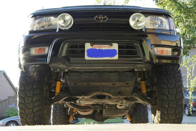

Did you end up using a diff drop kit or just the coils/shocks?

No diff drop required, since its only a 2" lift. If you get the top spacers, then you'll need one.

The ride is nice now. Didn't notice how bad it had gotten over time. The shocks are OME 90004 and 60028
