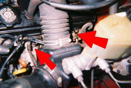

Alright, I got a picture. The arrows point to the main spots where it's leaking from...
Not the best picture ever, but it's all I could do.
-Keith

Okay, I must have screwed something up because it didn't post. Let's try this again...

dude,
looks like your valve cover gasket.
if you're good with these kinds of things, the job is cheap on parts, expensive in time, i believe.
should be $300 or so in parts & labor at a stealership. less at a local shop that knows what it's doing.

Yep it looks like your valve covers......

first thing first...
see if the bolts of the cover is loose...
go around and tighten them down. dont OVER tighten or that might make it worse.
you know which bolts are loose...

That was the first thing I tried. There were 2 bolts in the back I couldn't get to, but I tightened up the rest some. It didn't seem to make any difference either way.
Thanks for the suggestion though. Has anyone else had this specific problem and had the valve cover gaskets replaced? How much did you pay to have it taken care of?
I'm not too mechanically inclined, but if it's a matter of removing just a few large peices then I might go for it. I just don't like taking apart things with lots of intricate parts.
-Keith
