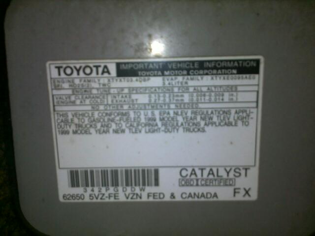

I was driving today and the cel came on. code p0133 bank 1 sensor 1 o2 sensor. Now here's the problem I cannot tell if I have California Emissions. I will attach a pic of the tag under the hood. From the tag it looks to be California but I only have 1 catalytic converter. and the exhaust looks completely stock. So how can I tell for sure which sensor to order? The markings on the original are: toyota 89465-35530 denso 0640. Any help would be greatly appreciated

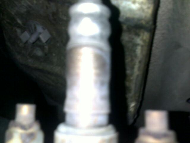

Got a picture of the sensor?
I have a picture of the sensor in the vehicle, but not one removed. I was wondering if they physically looked different. The pictures I see online show the A/F sensor to have just a couple holes on the sensor itself, and the O2 sensor shows to have a bunch of holes. I may see if autozone can order both Denso sensors and I can bring in my old one to compare. Also I was wondering about the P0133 code since it specifically states O2 sensor and not A/F. here is a post I found on another site from someone with a similar problem.

I've got it figured out. I talked to a friend and he showed me right on the sticker under the hood. It shows exactly what type of system it has. On the top left in the engine family section it says HO2S(2) meaning it has 2 heated oxygen sensors. Air Fuel sensor vehicles would say something AF.

It looks like a normal O2 sensor from the picture so yes, i think it is safe to say you have a Fed truck, pretty sure that is what the bottom part of that tag says as well.

Yes, that's a 49-state '99. The Cali. label has "CAL & OTC" where yours has "FED & Canada" and in the white space in the box there is language that starts: "This vehicle conforms to California Regulations..." and goes on with a lot of other Cali. BS. I have a '99 Cali'(bought new in NJ). It's also correct that a '99 Cali. CAN'T throw a P0133, per my '99 FSM.
