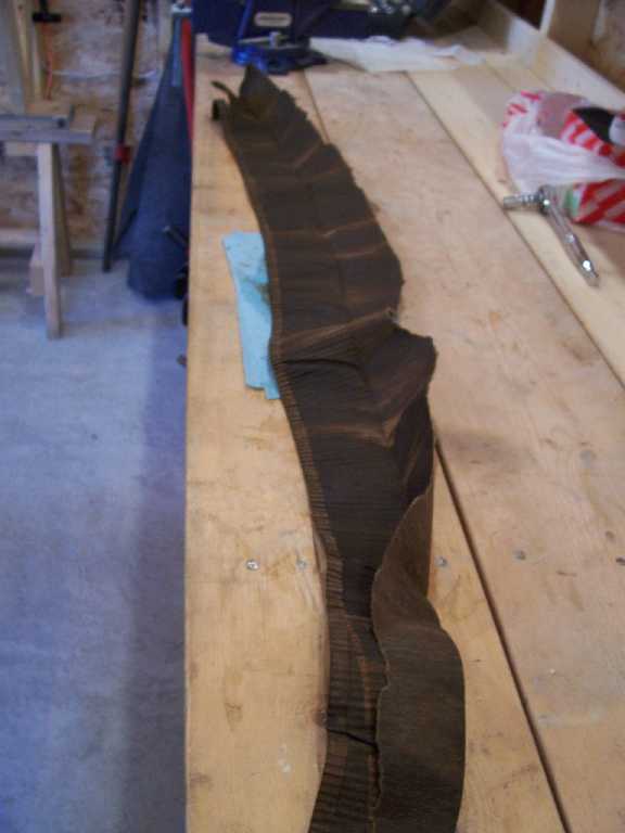

I just finished replacing the fuel filter on my 2002 4Runner. The throttle response noticeably improved with the new filter. When I took the old filter off the truck, the gas that came out of it was sort of dark, so I decided the cut the old "Lifetime" filter (as Toyota calls it) open to see what the filter media looked like.
The old filter had 100,000km (62000 miles) on it, and let's just say there was nothing "lifetime" looking about the filter media. 95% of the media was black, and I got black semi-greasy stuff all over my hands when I took the old filter apart and un-rolled the media to take pictures. I attached a couple of pictures below for those of you that might believe Toyota when they tell you that there is no need to change your fuel filter.

It's not too bad. I left the garage door open a bit when I was changing the filter out. Only about 1/2 quart of fuel came out of the lines & filter when I removed the old filter.

Anyway, I just changed mine tonight (101K miles) and the gas that came out of it was darker than normal too. Haven't driven it yet but started it to get the fuel primed. Wow, it started easier and the engine sounded much better than before.

New Toyota filter. Cost is approx $40 canadian up here. I'm going to change it out at least every 100,000km (probably sooner after seeing the inside of it, though)

Here's one I cut in two about two years back. Truck had about 110K miles on it at the time. Was quite dirty:

Where do you buy your gas? Not all stations are going to have gas that will crap up your filter like that in 62,000 miles.

I just changed mine last night.
Talk about an improvement in power delivery!
Oh, and the sludge that came out the back end was just incredible. 113k mi and a lot of bad tanks of gas took it's toll on this "lifetime" still-stock filter. I'll definately put this one on my list to change more frequently considering it's ease (easy location).
