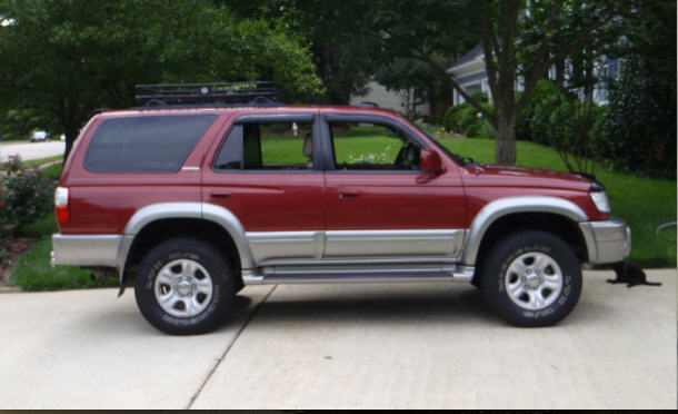

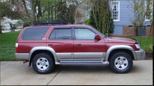

Before and After Pics
OK - I have just two pics of before and after. When I wear down these Michelins I will go up to the Nittos.
Alignment went well today, although they were BARELY able to get the Caster in spec. Biggest problem was the toe-in as a result of the OME front end, but that was easily taken care of.
One other thing - the rear lift definitely kicked the rear axle to the right just a tad - I would estimate 3/8 of an inch. Undecided if I will get the adjustable track bar - doubt it for now. I also can *feel* more than hear a rumble from the front end at higher speeds - not sure if it is the higher angle on the C/V's or not, since they are clearly not too extreme. I also rotated all tires in an X pattern, so I could just be hearing some rough tread from the formerly rear tires. I wil monitor and see if it goes away, but again, I really don't think it is worth a diff. drop, even if it is that easy.
One last thing - I read alot about the PITA the rear shocks are in removing and installing the new ones. I did not have any problem - with the wheels removed and the spring out of the way, I could easily get a 3/8 inch ratchet with a deep well 17 mm socket right on top of the nut, and just held onto the shock while loosening and tightening. Of course I could not turn the ratchet much more than a 5th of a turn, but I used to be a helicopter mech. for the military and this was nothing! Installation of the front assemblies was a cinch - total time for front and rears was less than 2 hours, including jacking and removing the wheels. If fact, while I was there I replaced my front brake pads with new OEM pads - they were past 75% worn and I noticed the difference immediately!
OK - enough babble. I have attach three pics - before, after and one of the CV angle.
Attached Thumbnails Nominal upgrade to 02 LTD 4WD 4runner-before-work.jpg   Nominal upgrade to 02 LTD 4WD 4runner-after-work.jpg   Nominal upgrade to 02 LTD 4WD 4runner-cv-angle.jpg
Hmm, you got me worried now....
