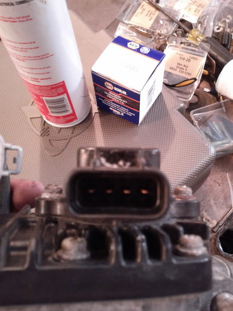

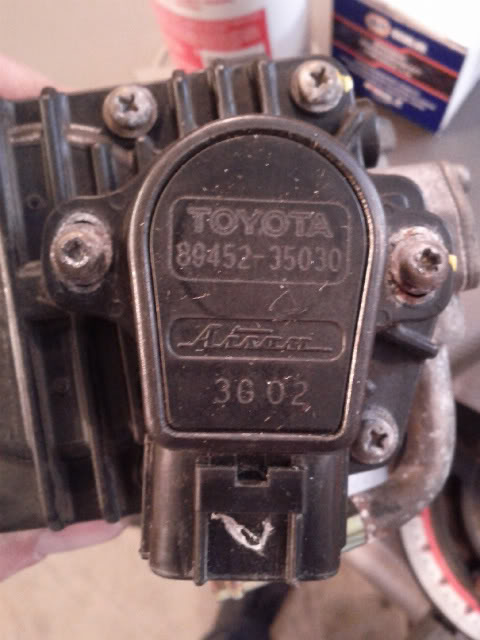

Alright.
So, bad news is NAPA has the wrong part # in their books for the TPS Sensor.
Good news is, i don't think i need it at this time. Looking closer to my 5VZ-FE throttle body, i noticed A) It was dirty, so i cleaned it (and the 5-6 holes in the top...) B) the TPS sensor is 4-pin, not 3 like the part listed @NAPA for the v6 5VZ.
I think i may have inadvertently adjusted it 'close enough' for it to work normally, i'm over 100 miles now with no issues since i loosened the top screw, maybe bumped it a hair?, then did the 100 pump trick... That's all i got.
Only facts i have on the 100 pump working:
Read about the fix (100 motions of the sensor) for the type of electronic part it is somewhere on the internet.
Truck the morning after loosening the screw, and later re-tightening, had the 'limp mode' problem. = No throttle response.
Key out of the ign. 100-pumps, no reappearance of problem in over 100 miles. I will update this thread if i ever have to actually replace the TPS.
This thread seems to explain my problem though it's about 01/02's
https://www.yotatech.com/forums/f180...or-tps-133112/
Also, and most importantly, the 2003 TOYOTA TPS is adjustable...
4-Pin
And on a side note... this is how far open the butterfly valve gets when the throttle is fully 'open' (when it's at the stop) - First 'third' of travel doesn't move the valve... Don't know much about fuel injected engines, i'm used to Carb's, so i'm guessing this is sort of a 'pilot' circuit until the next third when the valve opens and so on through the motion of the valve.
Also, changing the fuel filter... bad idea. So. Much. Gas. Everywhere...
