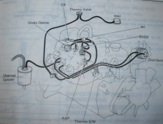

here's a link to the canadian vacuum diagram - https://www.yotatech.com/attachment....achmentid=4736
the only things i have blocked off on that are the charcoal canister(i don't have one on my truck anyway, previous owner probably took it off) and the thermo switch/HAI(i have an open element air cleaner, kind of pointless to hook these up). runs GREAT, especially since i had the carb rebuilt, but i'm gonna have to take it off and have them set the float level, since they put it so low it sputters out under any load
what kind of shape is your carb in? might be overdue for a rebuild if hooking everything up right doesn't work. if you or somebody else messed with the idle mix screw(it's at the bottom of the carb, you have to drill out a plug to get to it), turn it all the way in then back it out to its baseline of 2.5 turns out. generally you don't want to mess with that.
