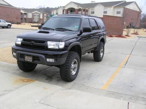

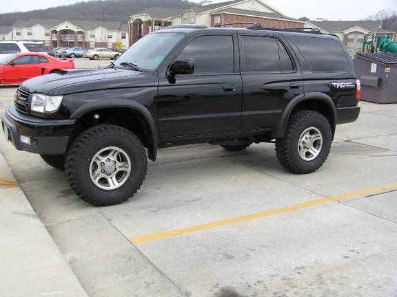

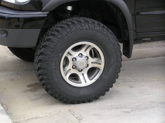

PICS
Fink
Attached Thumbnails New Lift Idea-close-up.jpg   New Lift Idea-side.jpg   New Lift Idea-wheels-tires1.jpg

Looks great! Those 3 inch front spacers give u alot of lift up front.

Yeah, a little bit too much...I can't wait to get all my stuff in for the new lift. Then I'll be all set and the Runner will be done....................for now
