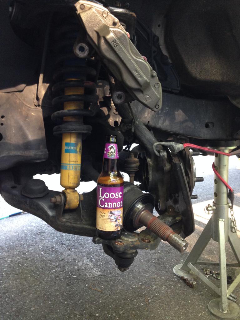

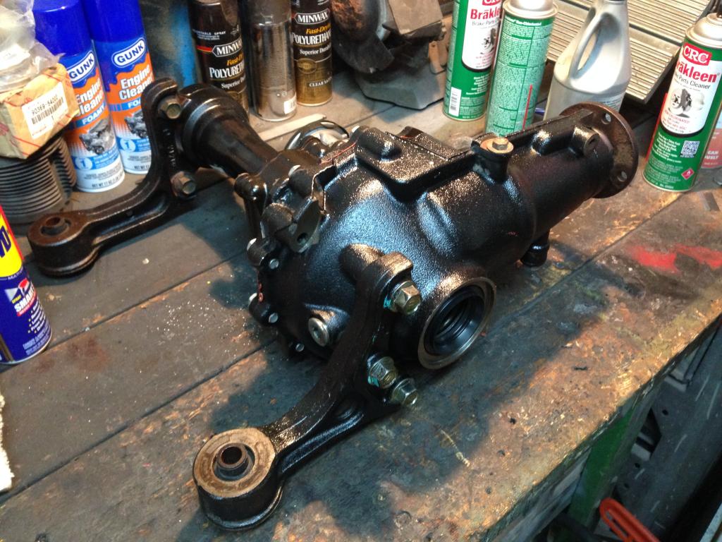

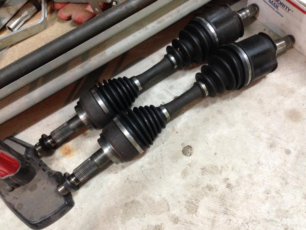

Since the 4Runner is my daily driver, I need to forge ahead with this bit o' maintenance... Luckily a good friend of mine is letting me use his '98 for as long as I need it.
I only had a few hours today to get a start on this, so I set the front on stands, pulled the wheels, calipers, and halfshafts. Tomorrow I intend on dropping the diff and hopefully bolting the 'new' diff into place. Then the plan is:
- replace both wheel bearings/seals
- install 'new' halfshafts
- button everything up
- aim for 400,000 miles
I'm still astounded that all of these mechanicals have gone more than 300k miles without a hitch. Love this truck!
