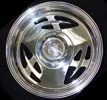

I have the stock 16x7(i guess 7)rims and was looking at purchasing some centerlines soon. The rims are 16x8 and have a 4.5" backspace. Ive read all kinda threads about backspace problems but none on the taco. Doe anyone know if I should get the backspace changed because centerline can on these wheels, or will it be ok?

16x8 with 4.5" backspacing will work just perfectly. Thats exactly what Bamachem is running with 285's. Which wheels are you looking at?

Good, I'm just running the stock 265/70's so thats good news. I'm looking at these from centerline:
