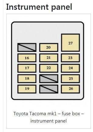

Have you checked all the 4wd fuses? should be 19 on this fuse panel on the left side of your dash
