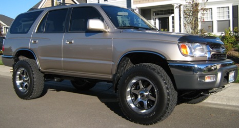

Finally a pic of my new wheels.
17X8.5 with a 4.5 backspacing.
BFGoodrich All Terrain TA KO 265/70/R17.

Looks good!

Those are nice looking - what brand are they?
any rubbing/clearance issues in the wheel wells?

Clean 4Runner....looks good with the black letters out.

Not too bling, looks good with your bumper and fender trim.

Hey they look nice! Great looking 4runner

The wheels are by "Amp Wheels" a Les Schwab brand.
The specific wheel model is called "bitterroot".
There is no rubbing (and no trimming) with 265/70/r17 tires and a OME 881/890 lift, they may also fit without a lift, but I'm not sure. I test fit a 285 tire, but it mashed the back part of the wheel-well pretty good.
I really like the look of the wheel, and for $139 a piece they were much less expensive than some of the other wheels I was looking at.
More pics to come when I get the rock rails installed, if I can ever decide on which style to get.

They look great man! Nice price too.
