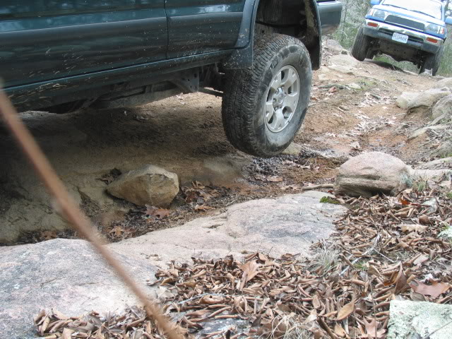

Are these teh stock 2001 wheels you are referring to in the post below Andreas?

Yes, those are the ones.
