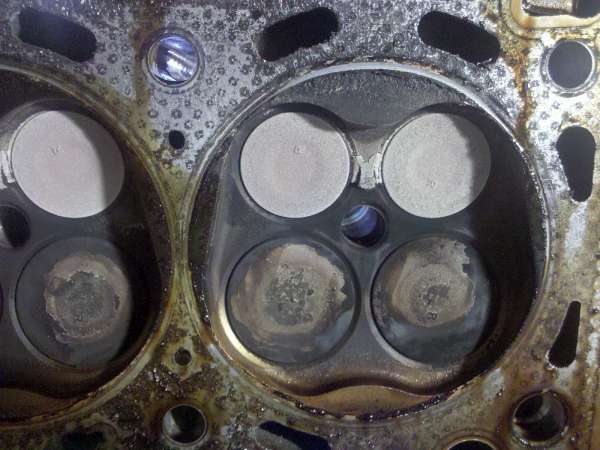

I pulled the head and didnt find burnt valves. I found WHITE cakey looking exhaust valves. i read that means the engine was running very lean. The cakey deposits i guess kept the valves from closing. The CEL codes pulled right before the work was:

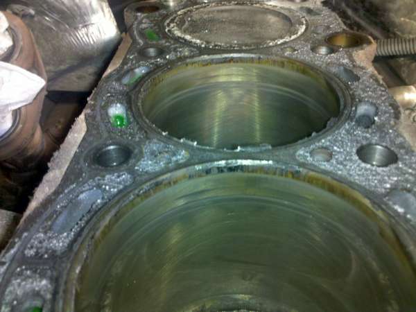

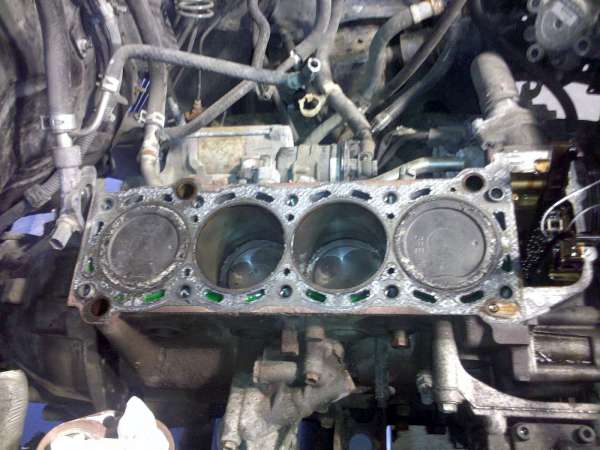

When I took the head off I noticed these ring grooves at TDC for each cylinder. I just just barely feel them. I was told its no big deal that its kind of normal for this engine. Each cylinder had them. Im thinking maybe it could be that. But then I am totally doubting it. Because the leakdown was great right after I installed the new head. Now I have 2 cylinders at 60%. Thats a huge difference.
Im runniing the output prssesure on the comp at 80psi. same as i did for the first test. even if the pressure from the comp was wonky it wouldnt matter. The cylinder should pressure to some extent and read out a % of leak.
Maybe the head gasket isnt sealing for those 2 cylinders? I clean the mating surface real good and the head was brand spanking new.
