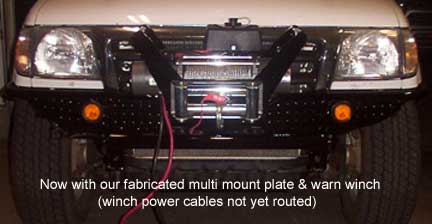

I loved mine-- I actually still use it but its on our Buggy instead of my old Taco. I made the bumper specifically for the our multi mount so that it sat up really high. I could take it out , and put in a feild goal type of rack , and then carry 20ft sections of steel. Oh , and on the buggy it hooks up front or rear!
Richard
PS- we dont make this anymore.....only picture I could find quickly.
