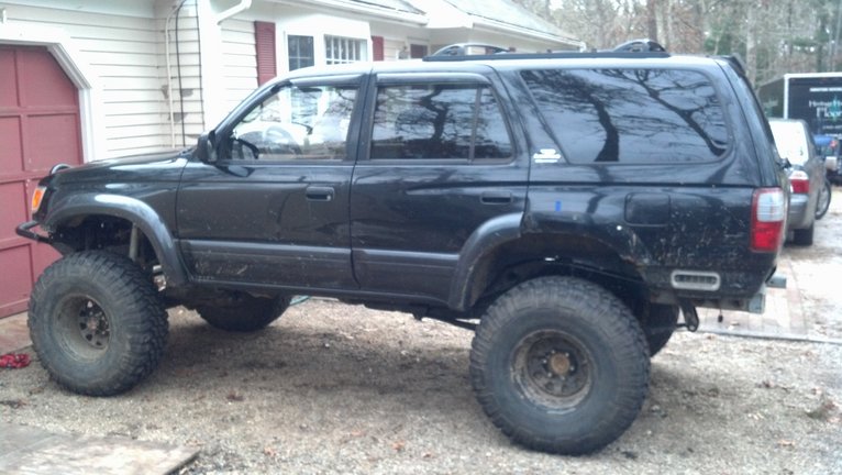

i had got the 1655 weight springs off that site. couldnt pass up 80bucks each. so far they ride good with bilstein shocks mounted straight. the only thing i dont like is the tank and me and battery make 1 side 1.5 inchs taller. fuel cell soon..
