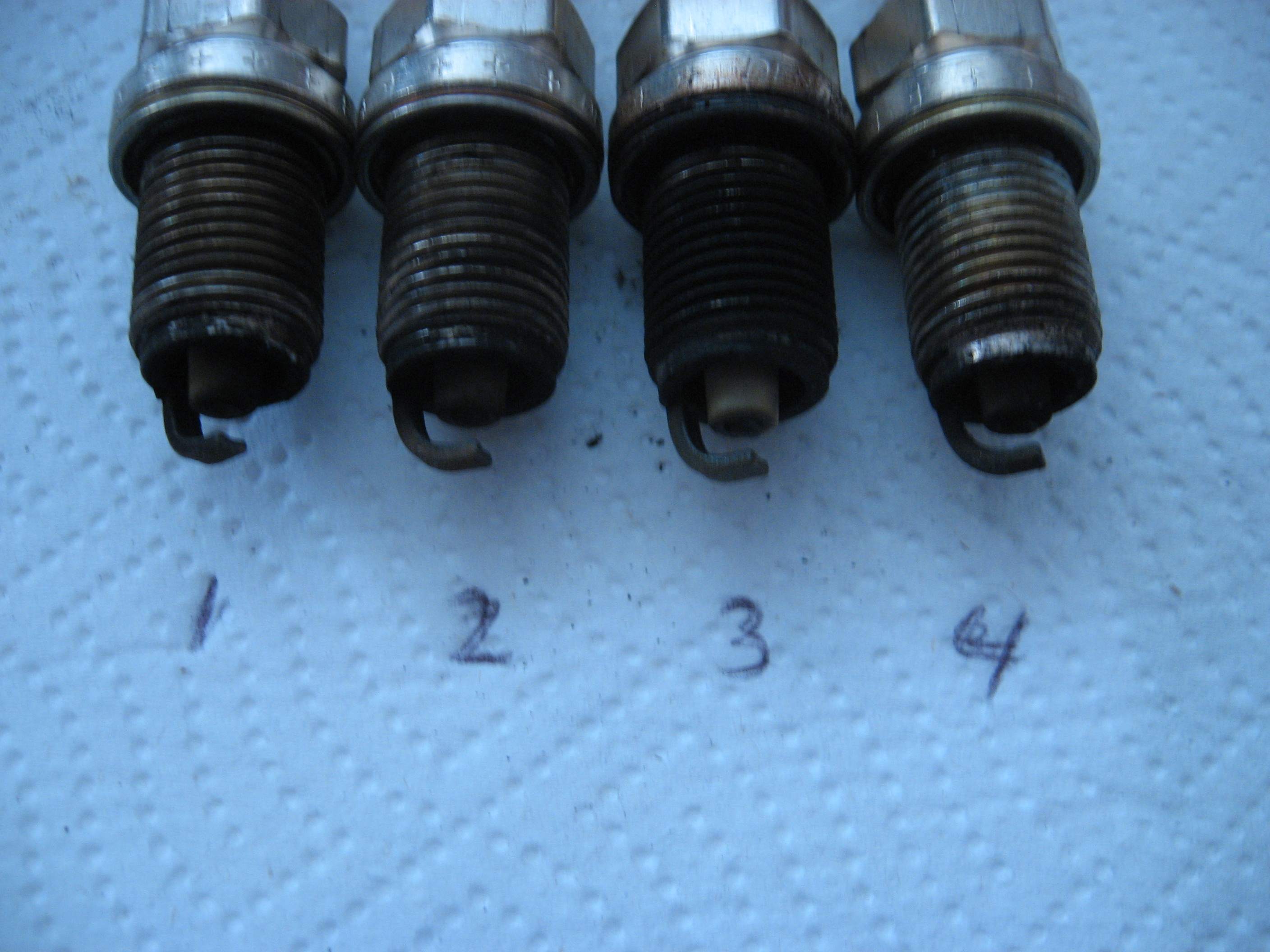

I changed the plugs (Toyota OEM NGK). I now throw C0300 (random), C0303 (cyl #3) and C0304 (cyl #4) misfire codes.
I have photos of the old plugs - really bad looking. #3 looks a little whitish, am I correct or imagining a possible head-gasket leak?

Time to perform a compression test. Ever overheated before?

No overheating. I have yet to perform a compression test on a deeply mounted spark plug hole. My guess is I'll need to get an adapter of some sort.
