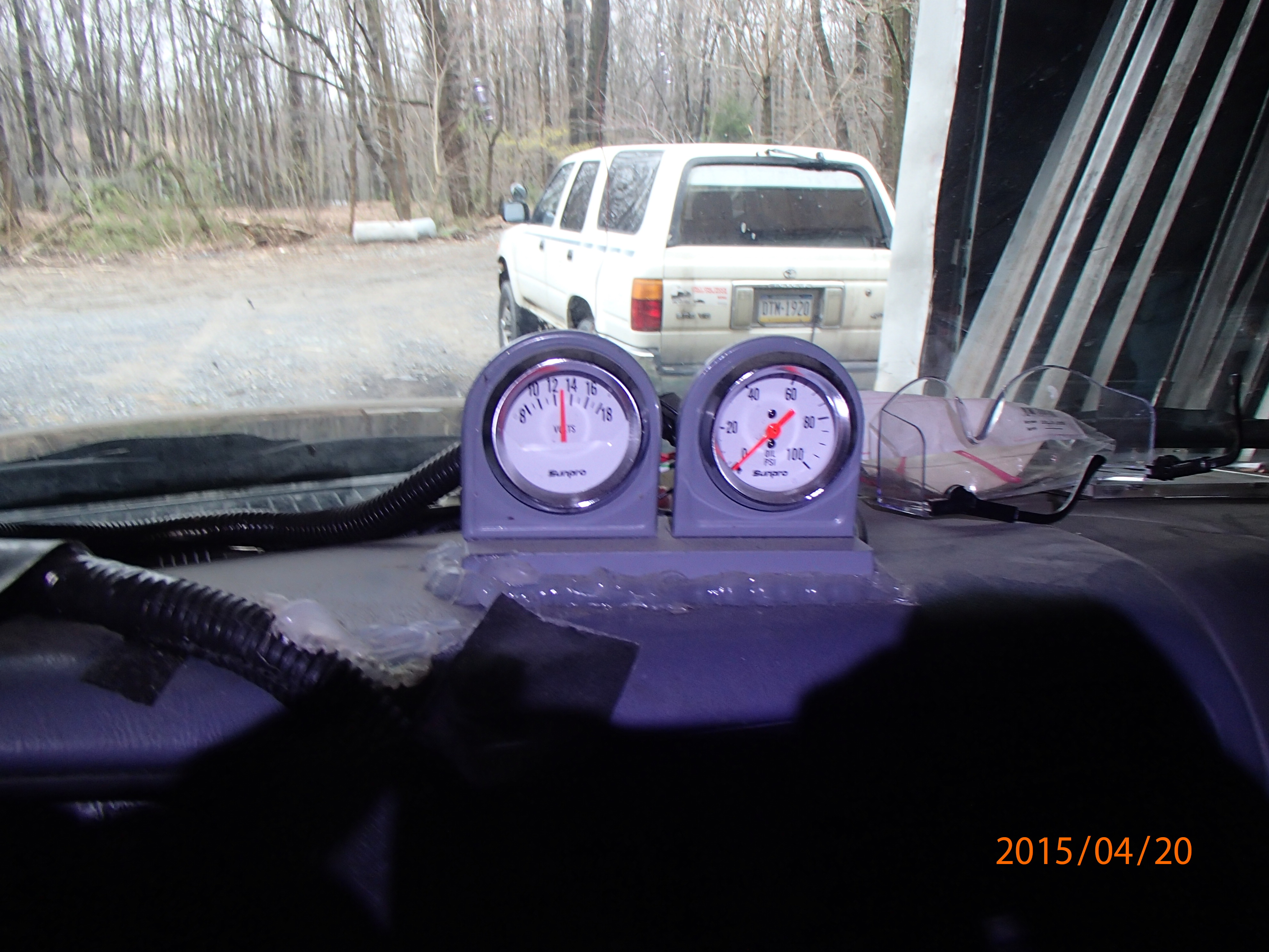

I put mine on top of the dash.
Easy to see not in the way of anything.
All my Toyota`s have two gauges up there I did not like the A pillar Pod to distracting to look at for me.

You can put anything anywhere. Offhand, you'll have to lengthen the wires tremendously and route them up there. If you can do fiberglass works, you can make them look good. Do what you want and are capable of. I throw mine on top of the dash in the corner by the windshield personally.

Here is the ones in my Tacoma
Mechanical oil pressure and Volt Meter
One in my 4Runner has oil pressure and Temperature gauge
