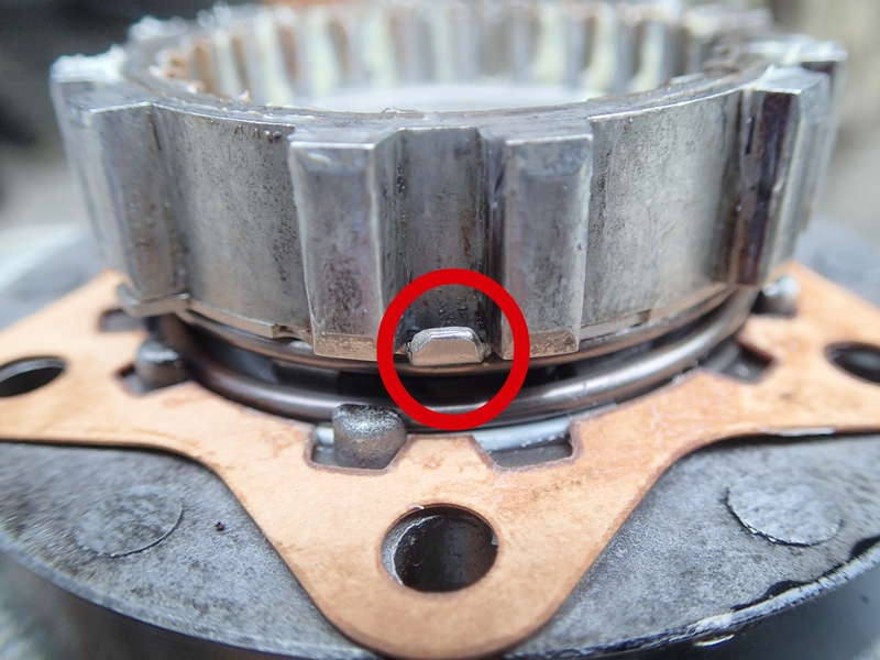

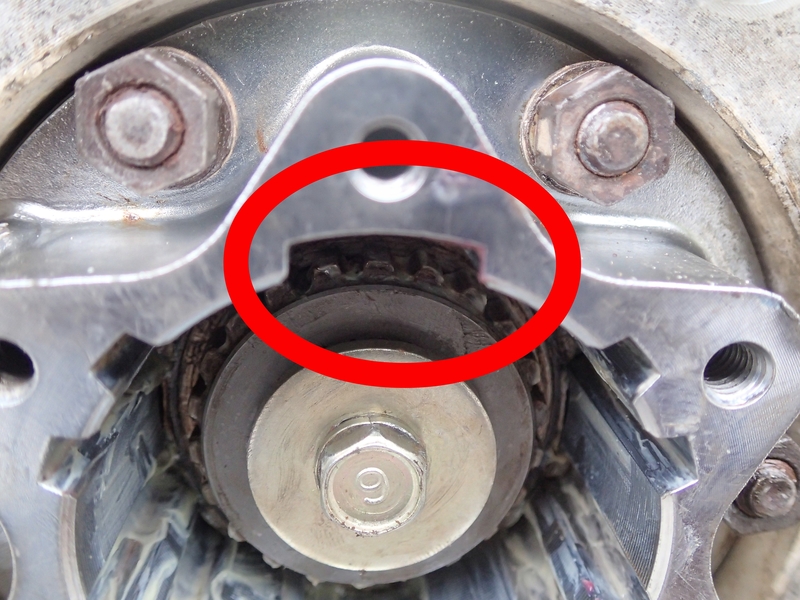

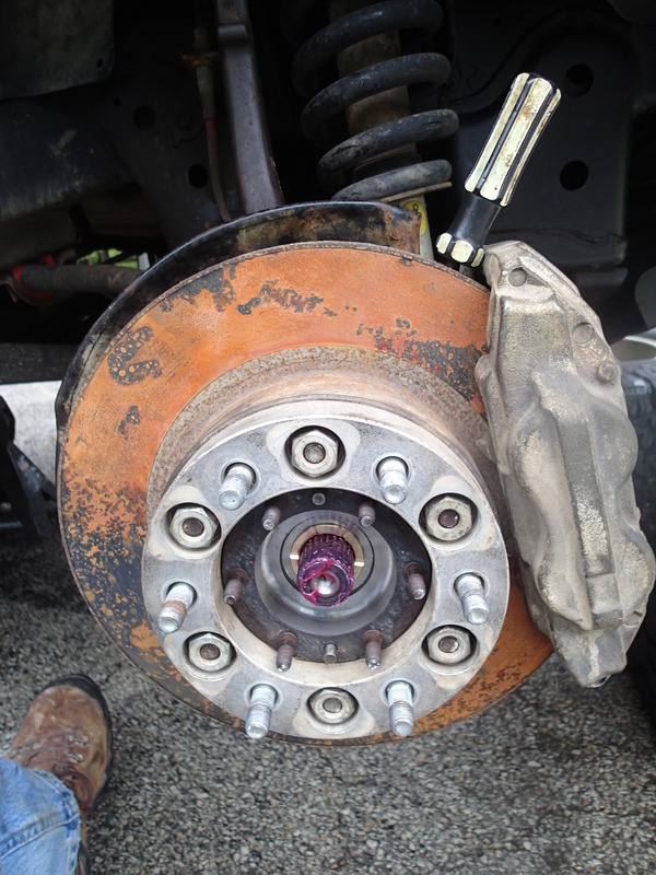

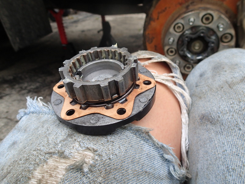

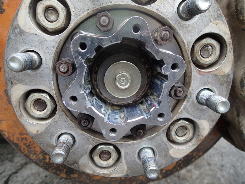

If you've got to get a cv shaft out of a manual hub first turn the dial to 'FREE'
Undo the 6 bolts that hold the dial on
dial should come off
unbolt the bolt w/large washer at the end of the cv shaft
Take out the 6 bolts or nuts (I have one hub with each) that hold the hub body on the flange. There are a variety of ways to get those stupid cone washers to pop out. I find colorful adjectives don't really help.
Take off the clip (not pictured) holding the shaft on. It's right in front of the washer pictured...
and you should have this (with or without wheel adapter):
Remove your 4 lower ball joint bolts and pull the spindle towards you. The cv shaft should be encouraged to leave the hub (I pushed mine out with a thumb)
Then it's business as usual for a cv change.
When you button it back up grease the bearings inside the hub in the spindle and the shaft. Once you get the shaft through the spindle hub it goes washer, c-clip (you may have to seat the shaft until the groove for the c-clip can be seen), hub body, little gold bolt w/big washer, dial w/mechanism and spring. The gear on the dial part will only go on a couple of ways. Where there is a small clip in the groove between 2 teeth-
that only fits in the larger single cut-out.
The torque specs on all this stuff is light, don't over do it.
You can see the brass bushings and the 4Runner's original abs reluctor ring behind the lock nut...
And the needle bearings (pre-greasing). The old race isn't easy to get out of there....That bushing and needle bearing is the part that got destroyed when Toyota tried to press it. The only way to get those little pretties from Toyota is to buy the whole hub that goes in the spindle. That's where ORS's having those parts solved what could have been a very expensive situation.
