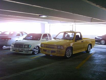

then i guess what i need is a supra rear. i see a locker being more useful in offroad use than on road where mine will stay. i have no plans of offroading.
i'll show you why lol mine is the yellow one.
