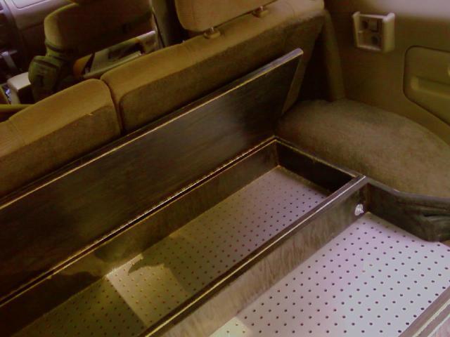

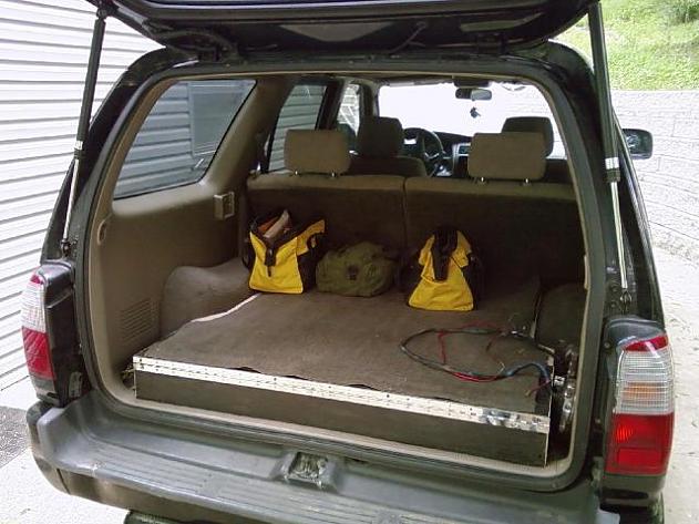

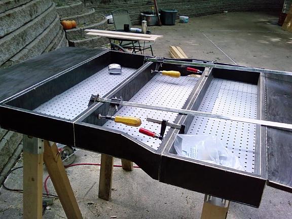

Here are a couple pictures.

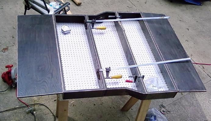

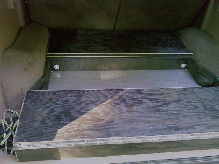

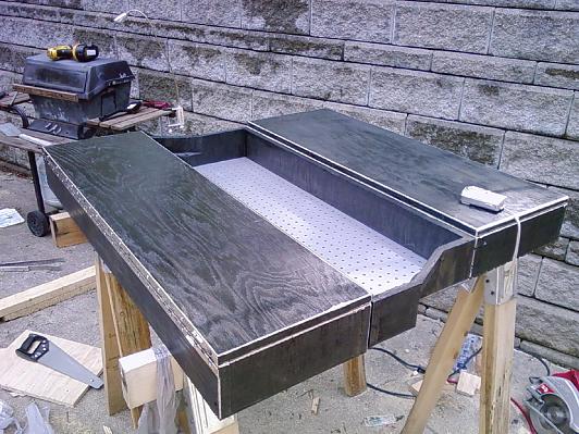

Here are a couple more pictures. The three seperate boxes are bolted together. The center lid will lift off. The other two have hinged lids.
Attached Thumbnails Low Profile Cargo Box 3rd Gen-4runner-storage-boxes4.jpg   Low Profile Cargo Box 3rd Gen-4runner-storage-boxes5.jpg

Looks nice, only problem i see is that those boxes are not acsessable unless the trunk is empty.

From: Southeast Missouri
Yeah and drawers aren't accesible unless the back door is open... And I didn't want to spend $200 per drawer slide.
Opening the back door is hard?
Good idea, better then nothing that is for sure. I know that i alwas have stuff int he back of my truck so having to unload all of that to get tot he stuff in this would be a pain.
No, opening the back door is easy... I just didn't want to spend the $200 x2 for the 2 sets of drawer slides. I hinged the front and rear boxes so I could access them from the open rear window and from the back seat. I actually designed these boxes for gun/tactical gear storage. I wanted to be able to access the gear from inside the vehicle from the back seat or by rolling down the rear window without opening the back door so when I do have guns and tactical gear back there it won't be as visible to the general public. When I have cargo in the back the boxes will be locked up and provide secure storage. When I go to work or to the range then I can throw my tactical gear or range bag on top. When I get to the range or work then my gear bag is usually the first thing to come out, then I can close the back door and if I need to get more expensive stuff out of the locked storage boxes I can do so without drawing unwanted attention.
When I am tailgaiting or camping the lid of the rear box with the piano hinge opens flat and makes a perfect table for drinks or food or whatever. I'm going to cut out some soda can sized depressions in it with a hole saw to securely hold beverages during such activities.
I have less than $100 invested in making these boxes.

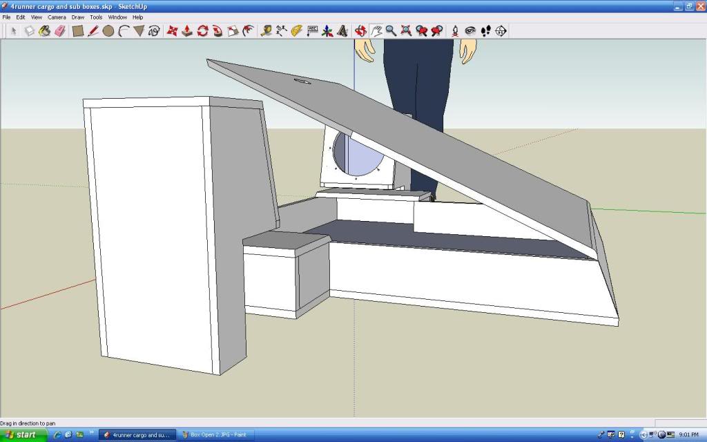

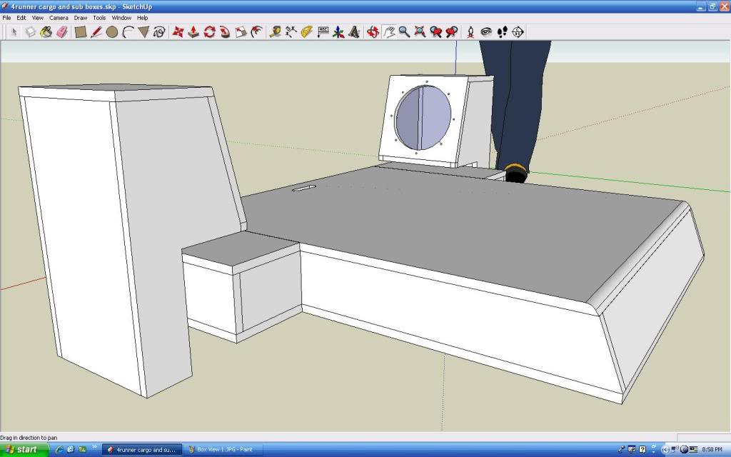

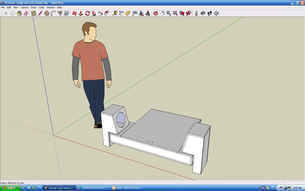

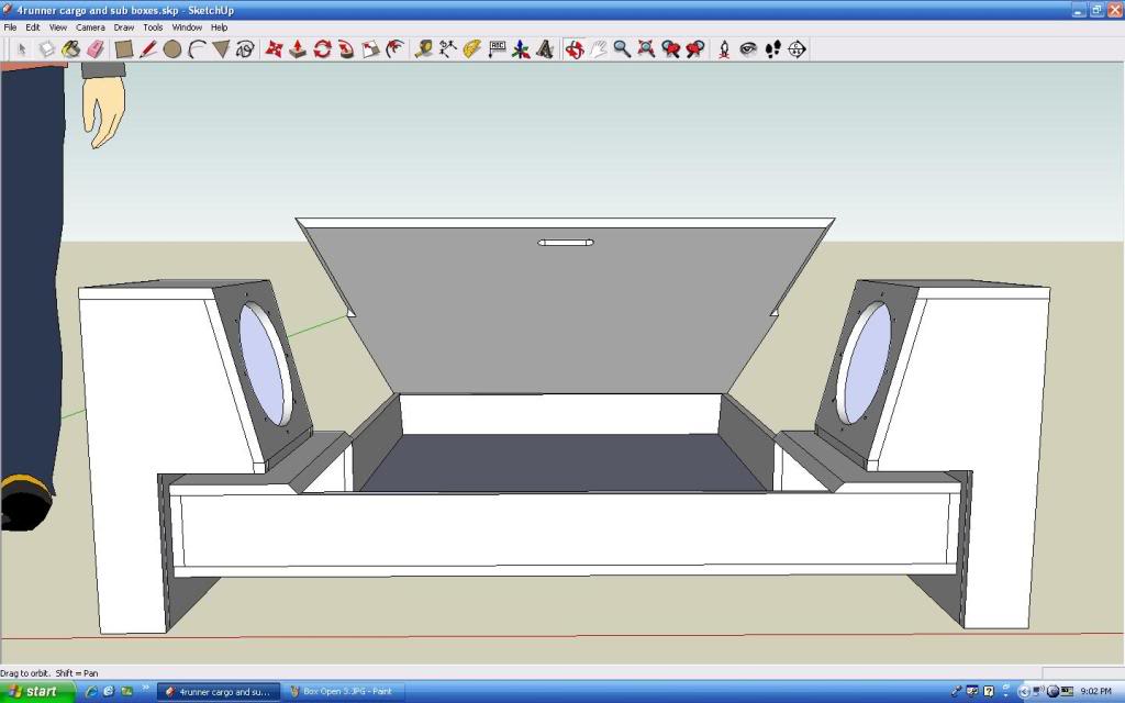

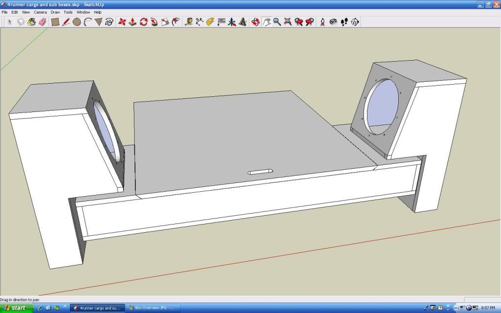

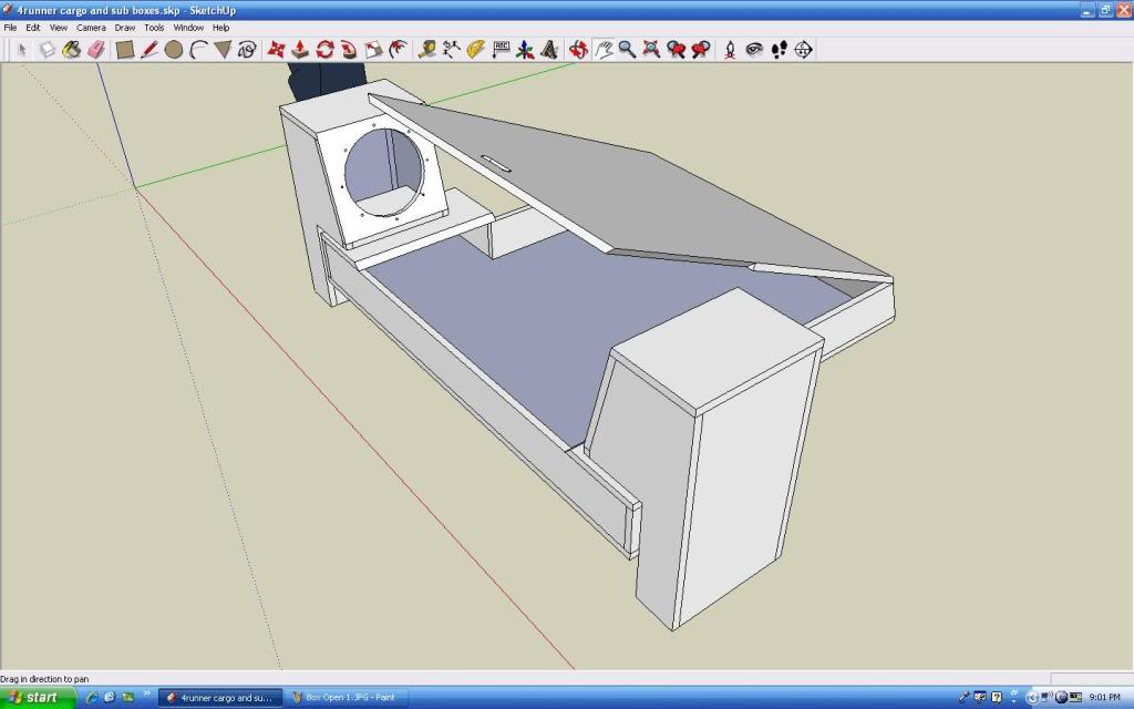

OK so I was bored this afternoon and decided to put my idea into SketchUp. I have a big box with a single lift door on the top and the two on the sides are for a JBL P1022. 10" subs with a 700rms watt JBL amp. They will be sunk into the side cubbyhole things with the plastic trimmed around them. The measurements arent perfect and it will obviously need some changes when I put it into action but for now everything is within 1/2 inch.

Oh yeah and the area around the fender wells will be form fitted to the fender wells like glenyoshida did. I just didnt want to try to draw that out.

Looks good, i need to get off my lazy butt and do this myself.

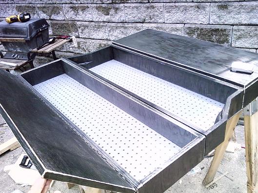

Here are a few mor pictures of my boxes.
Attached Thumbnails Low Profile Cargo Box 3rd Gen-4runner-storage-box7.jpg   Low Profile Cargo Box 3rd Gen-4runner-storage-box-6.jpg

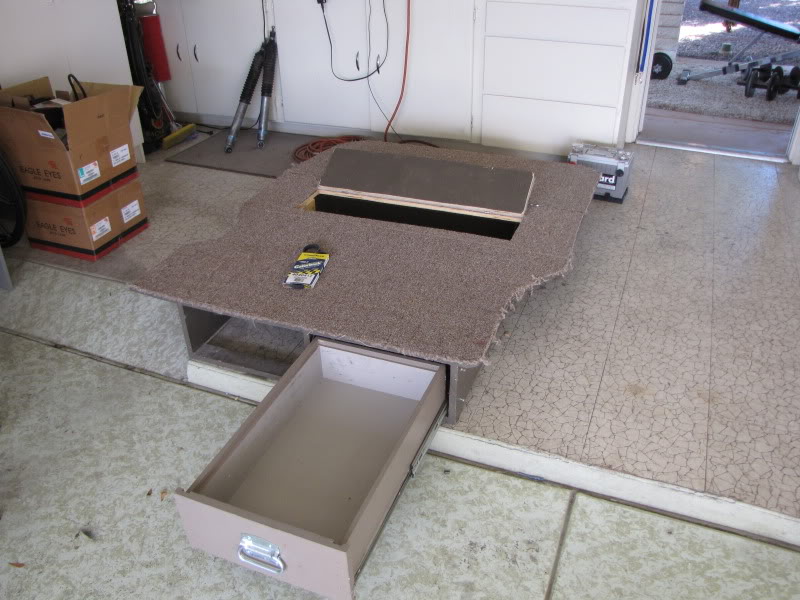

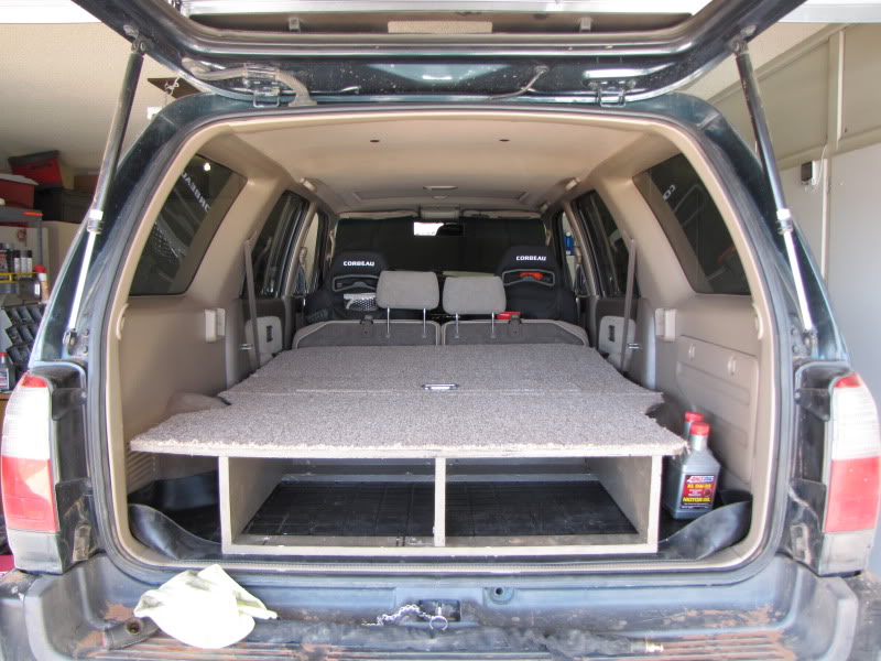

Originally Posted by glenyoshida
Another Cargo Box idea for ya geared toward expeditioning. I like to camp but don't like setting up and tearing down tents. I built this for my 2001 4Runner.
I got tired of loading and unloading my gear. I think this will help a lot. For reference, the aluminum drawers hold as much as a pair of cargo drawers made of just 3/4" ply that is 8 inches high and 20 inches deep.
The cargo box is low enough for a person about 6 foot and under to sit upright without touching yer head on the ceiling.
Tah Dah! All done.
