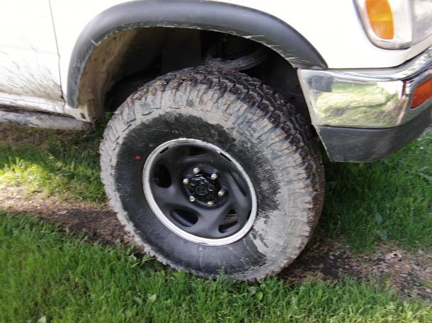

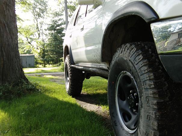

Hey all. I finally got around do getting the lift on my truck. The rear are land cruiser coils that gave me about 3.75" and the front is 3".
I had to remove the rear bumpstops off the frame to get the spring compressor to clear when installing the new springs. Well... The bolts for each one broke off in the frame.
I was wondering if these were the bumpstops that I need to limit travel while flexing, or is it the ones in the springs that will contact first? I can get the bolts out and reinstall the bompstops if you guys with experience say they should be there.
Anyways... Here are some pics with the lift and 33" Bighorns that fit very nicely with minor trimming of the front valance and the rear flares.

Looks really good man!

Looks good man, I'm not sure about the bump stops though. 1 of mine broke off (rusted off) and I have not had a chance to get the LC coils yet. I'm not sure what kind of issue you'll have with out them. I'm thinking the tires may rub, but with the LC coils you maybe alright.

Lift looks great and I like how you taped off around the lip of the wheel and painted the rest black. Looks just like a simulock style wheel!!

98.T4R, I used aluminum spacers in between the strut mount and frame. Not the most ideal way, but cost effective and I get the same ride but not the maximum flex.
GenXr, Thanks. I have another car with the bead of the rims polished and thought I would go for the same look with these rims. They turned out pretty decent for a $40 set of rims.
