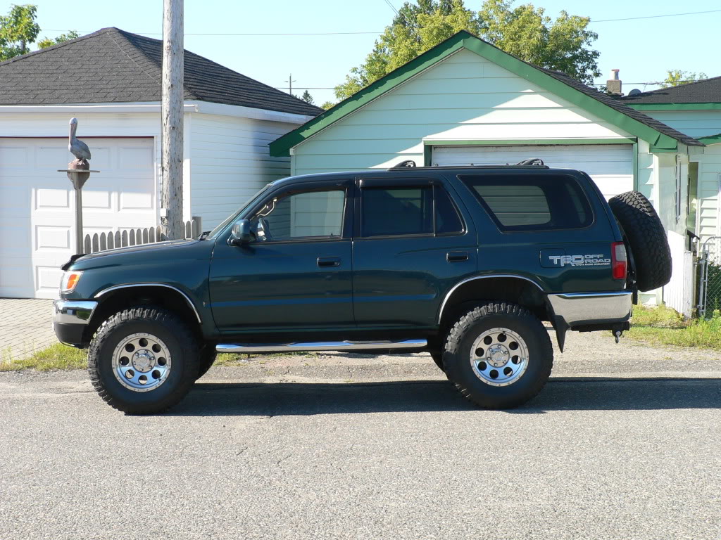

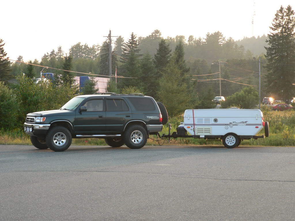

I'm running LC 8 Wraps with stock 2002 TRD Access CabTundra struts with a Toytec Top plate spacer, diff drop and a homemade panhard drop bracket. I personally love the ride quality! Even loaded, the suspension just seems to float, and the ride is "Cadillac like".
Here's a side profile pic of my rig with that setup:
Here's another side profile pic with my rig fully loaded and a tent trailer in tow:
I pieced my kit together, and saved myself a ton of money. Even with shipping to Canada, the cost of my LC coils (got them free...used), Rear shocks (Skyjacker....gonna upgrade to LC shocks though), Tundra strut assemblies (used), Toytec Top plate spacers, diff drop, and scrap steel for my panhard drop bracket....was under $500.00!
Now, I can say that I ran this setup without the panhard bracket for 2 years, no real issues, other than the axle sticking out more on one side....hardly noticeable. I never extended any brake lines...although you could go to any part store and just order those yourself for less. As far as bump stops, you can get some off E-bay....seen them before...but never felt the need to buy them.
