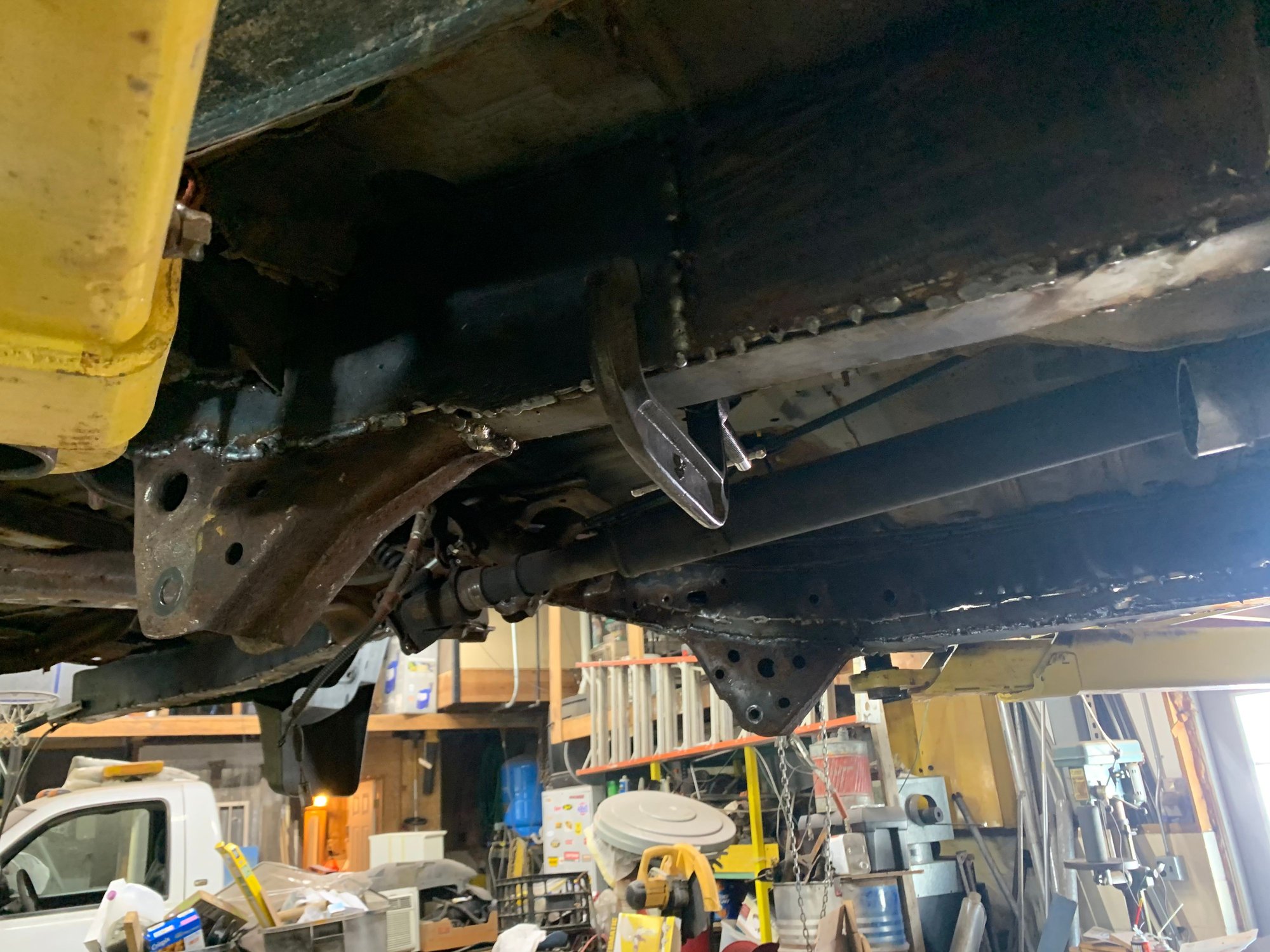

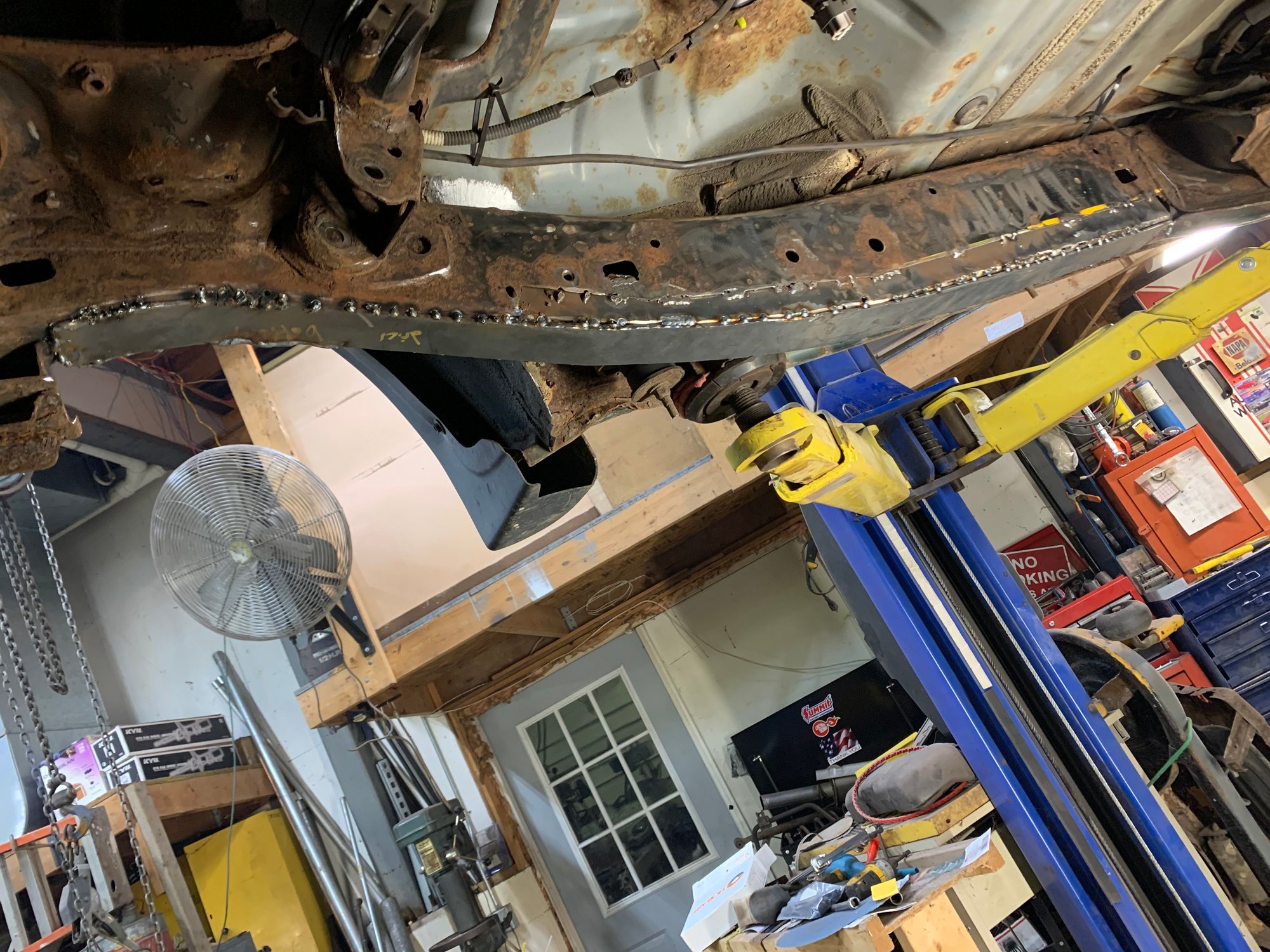

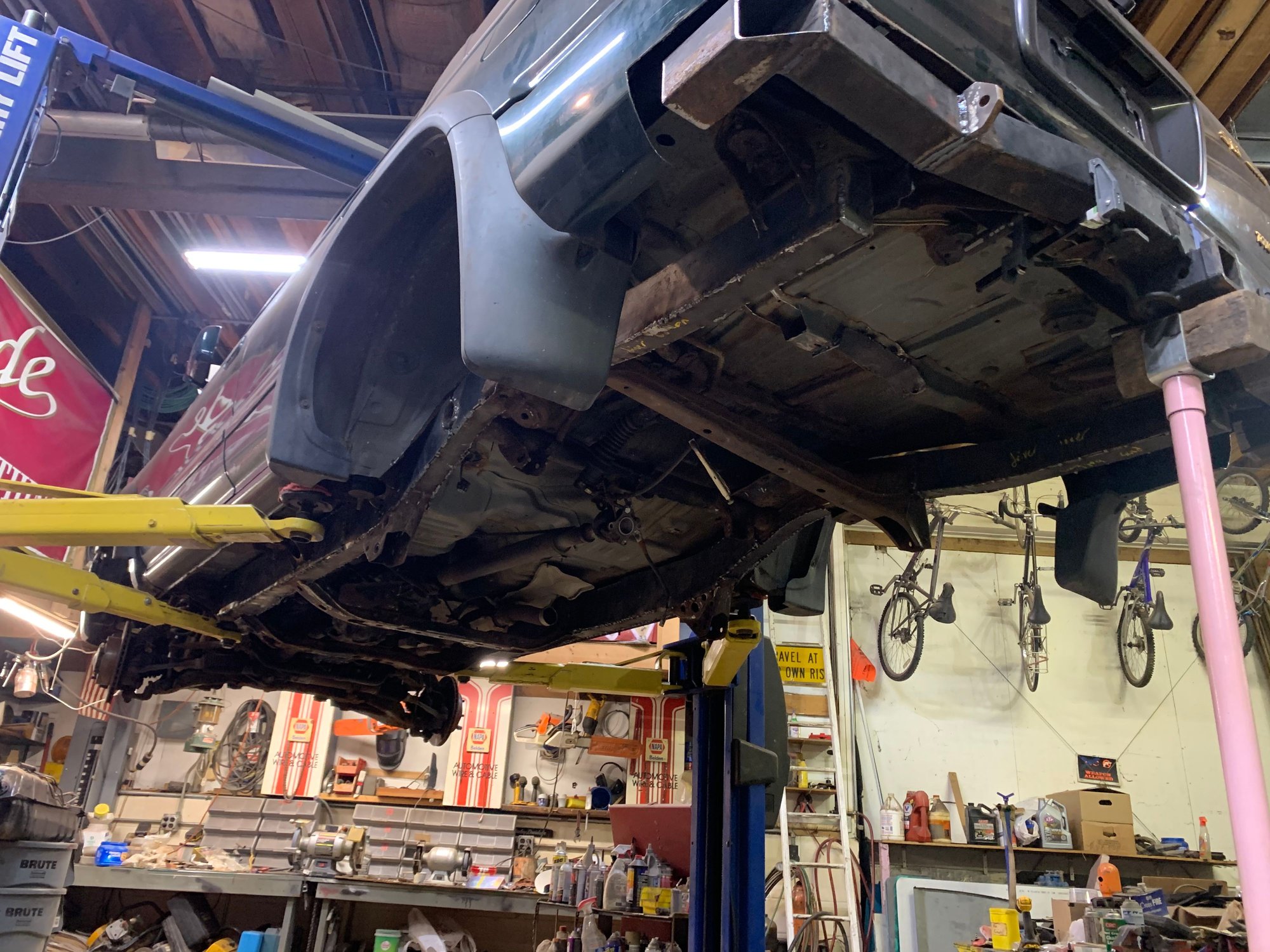

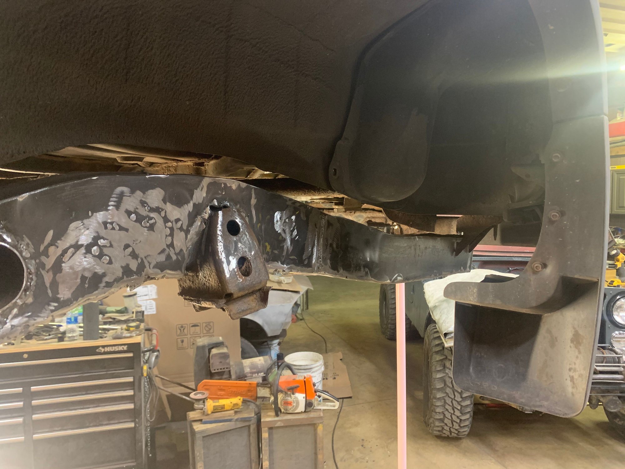

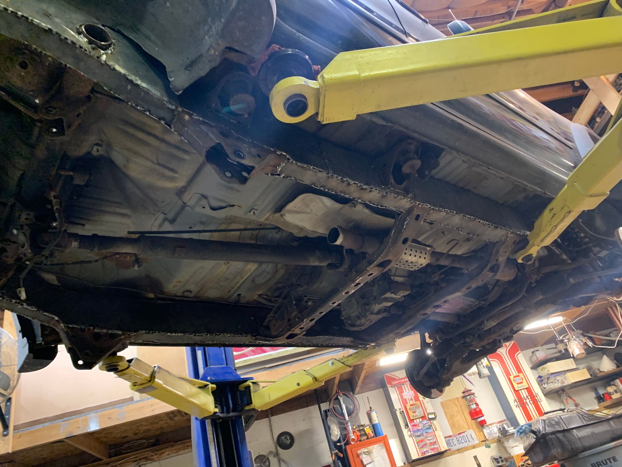

Have the link mounts reattached and almost all of the frame patching done. Forgive my welds my welder doesn’t like 110 and I’m not the best welder anyway lol
Step one was getting the frame back to having some structural rigidity by replacing rust with similar thick ness plate and stitch welding it. Then came attaching the link mounts, and plating over both sides so each link mount is welded on each side twice. Looking like it will be almost 1.5 times stronger than factory

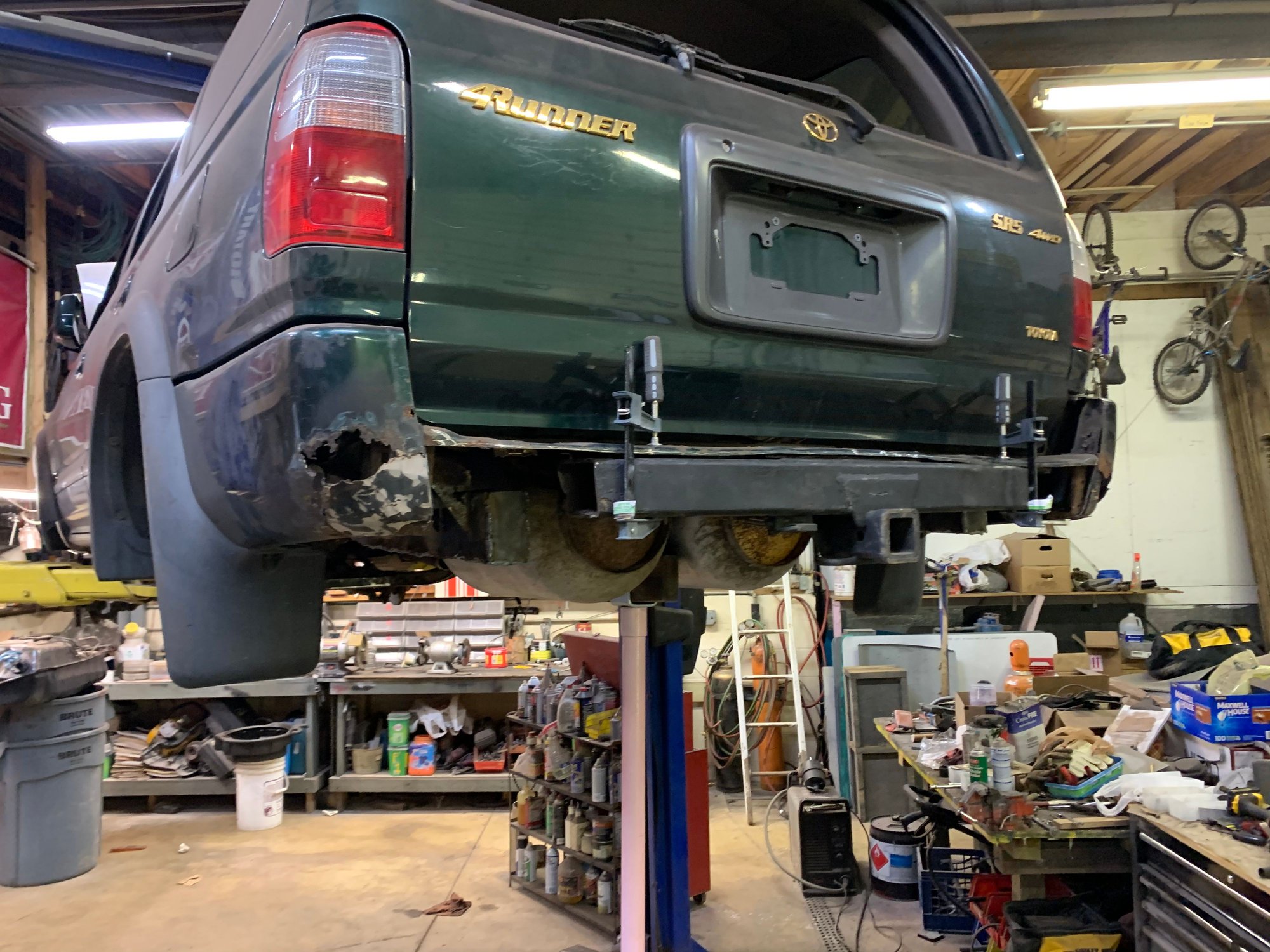

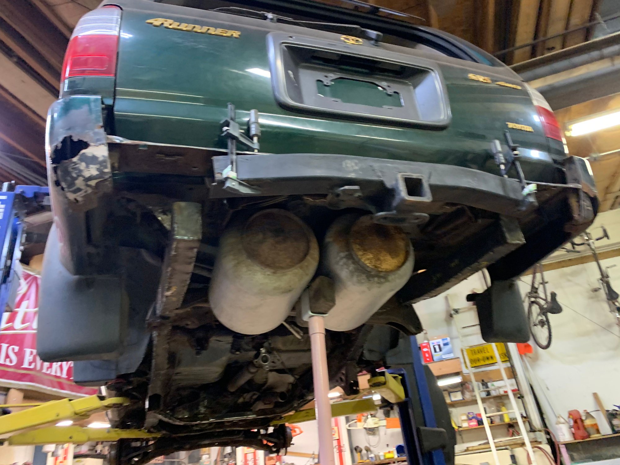

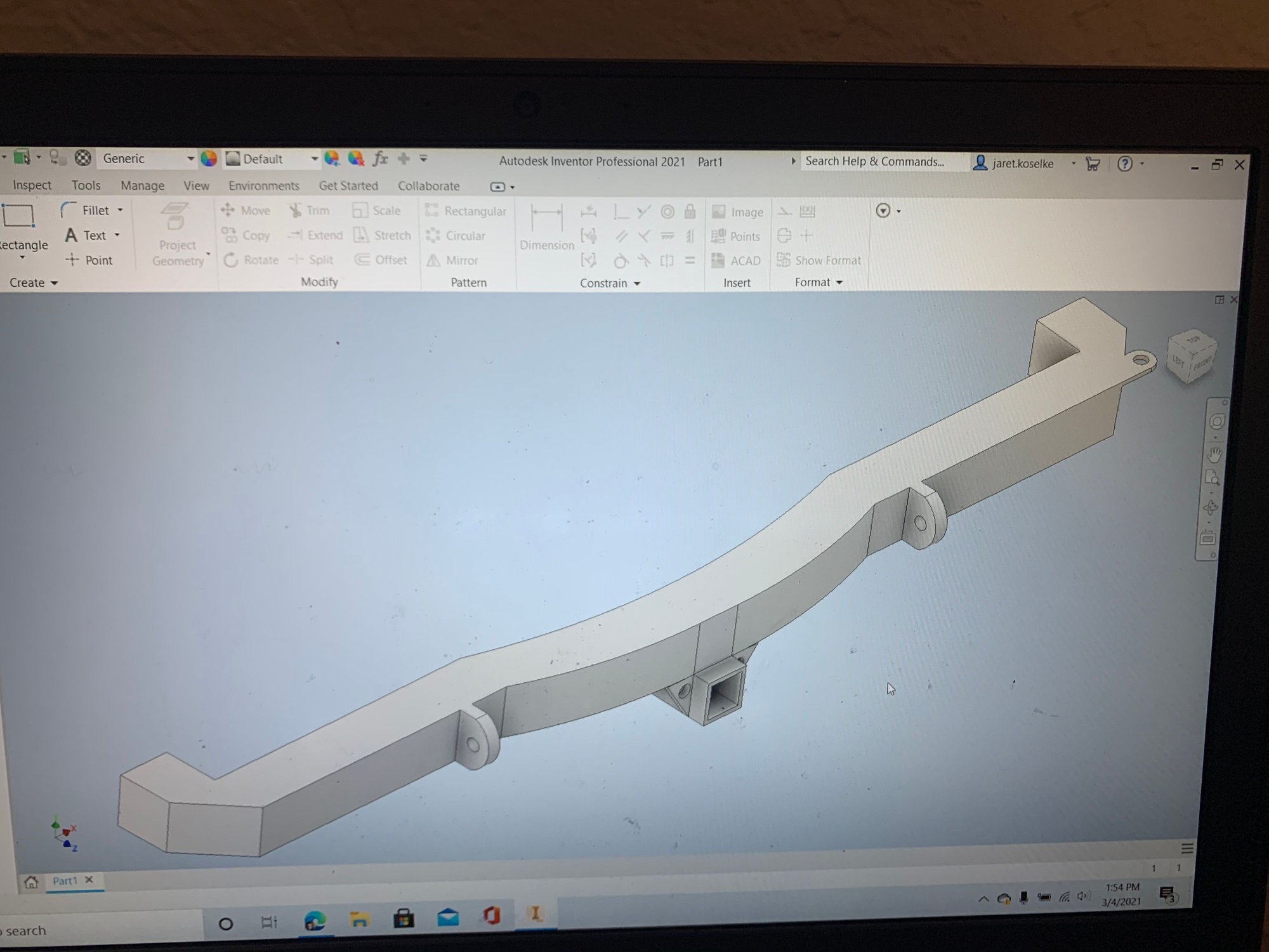

I got my bumper designed and built. Only the fine tuning and mounting left.

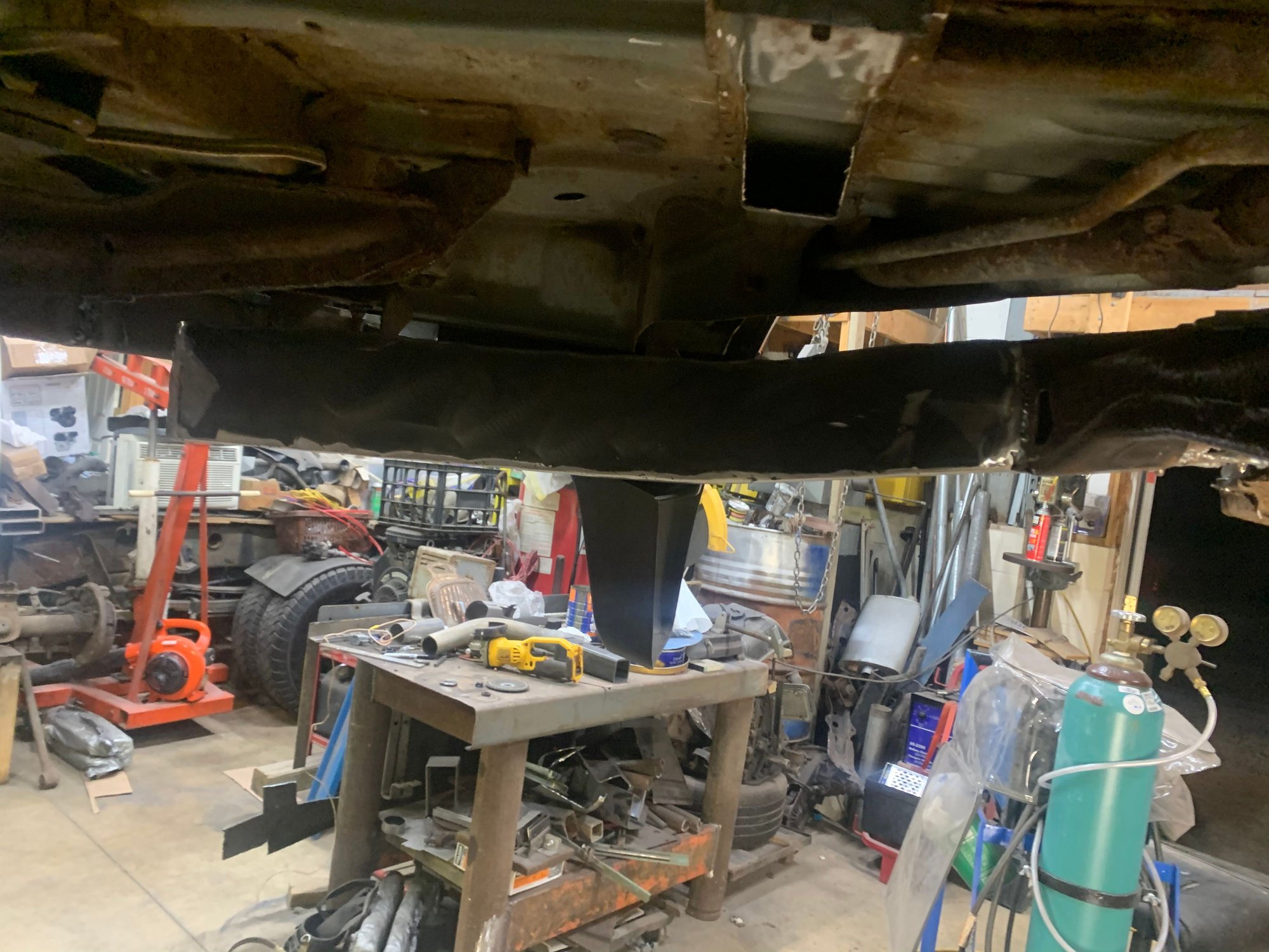

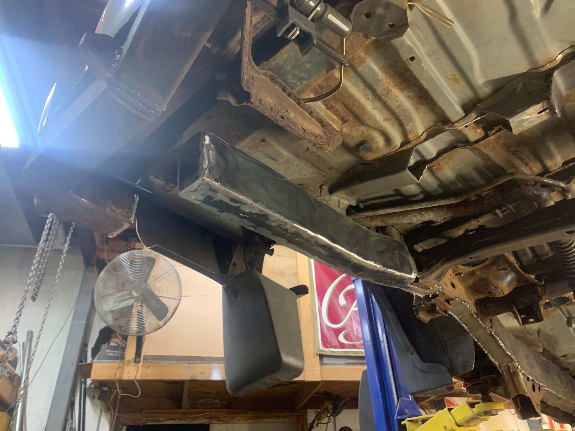

Finally got all my frame panels in one place, now I just gave a full day of welding and grinding. Have to shave some brackets and repair a broken upper link mount on the axle housing. Then make my bumper brackets. I’m getting close!

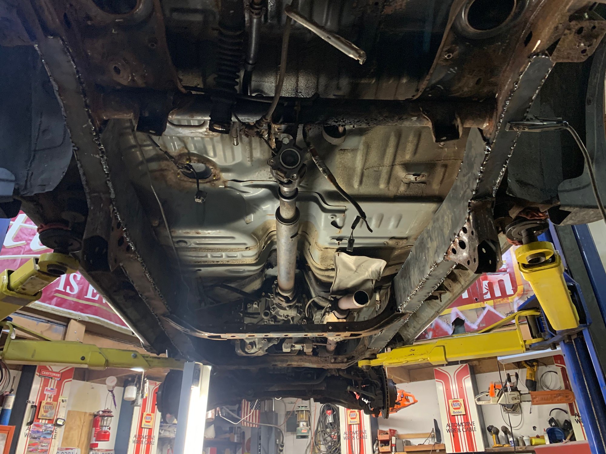

Made some beefier/ longer upper links yesterday. Also got all my links cleaned and coated.

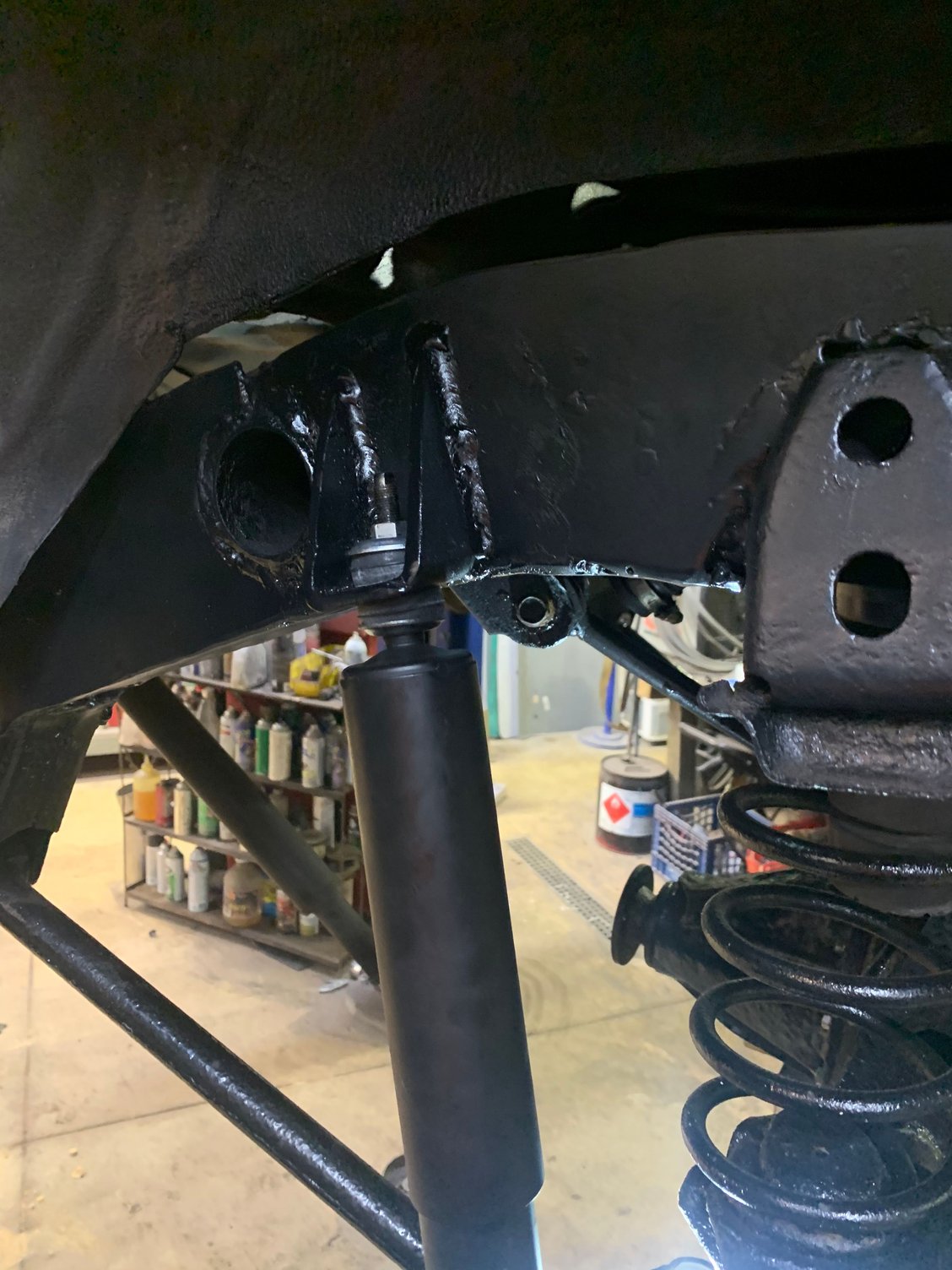

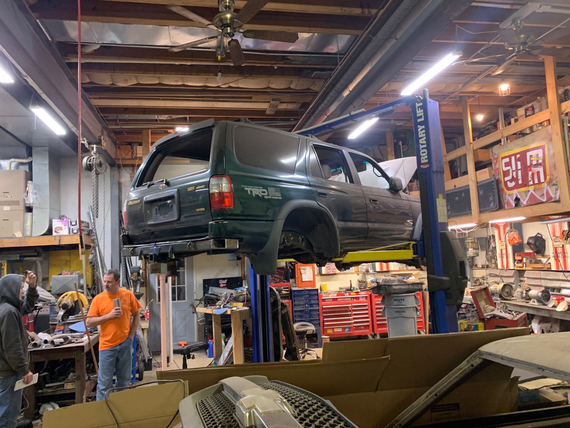

Been putting in a lot of work on the 4runner recently. Got all of the frame work done, bumper done, and the whole underside from the front arms back coated. Made some rear outboard shock mounts and had to clearance my lift kit a bit. Still need to put on exhaust, front lift and accessories.
1/4 wall tubing cut in half to make the outboard shock mounts. These are set up for stock length shocks for now.

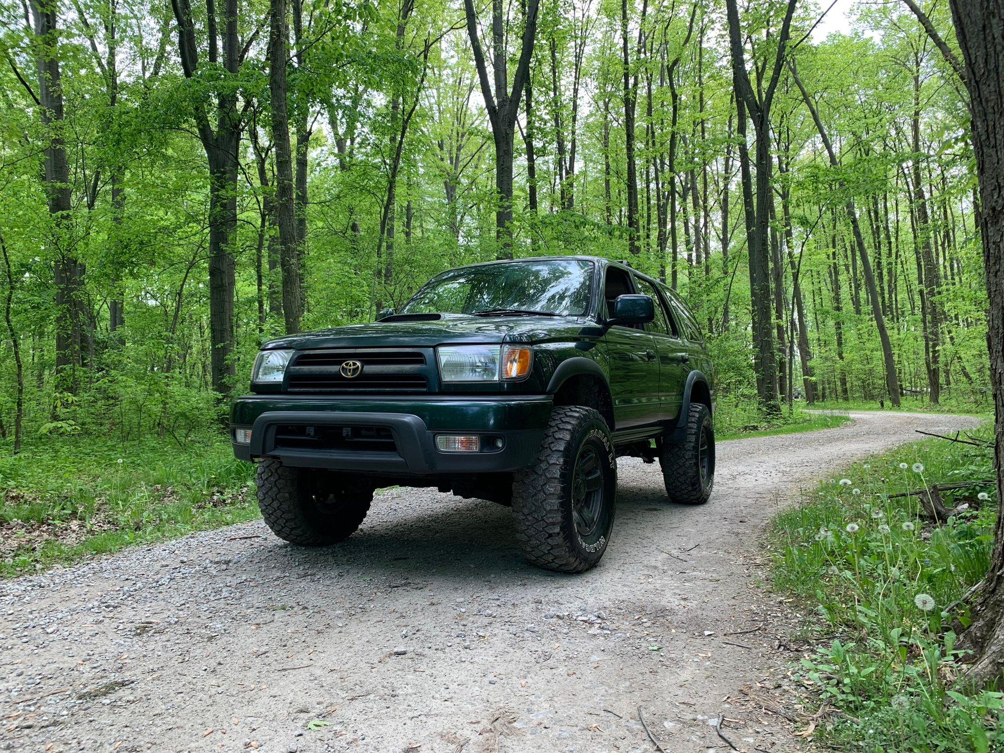

Anyone still here? Been enjoying the 4runner last month or so.

Nice looking truck!

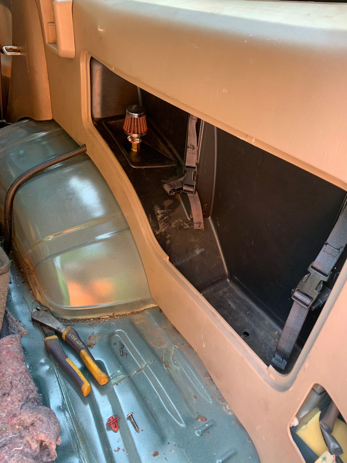

I really like the work you've done on the underside. Very impressive. I dig that K&N diff breather, too. I can't think of a better place for it. Just don't pile too much "stuff" in the storage compartment!
Keep up with the updates! I may not comment all that much, but I DO enjoy seeing the progress you are making. I can't be the only one...

thanks for the reply Pat. I appreciate the kind words. My hope for the cubby was only a first aid kit or maybe a an air chuck container.

I'm not all that familiar with the Gen 3 trucks, yet. Only bought my 99 4Runner recently. I'm still learning.
Having said that, isn't that cubby, in the original design, made to hold the tire changing kit Toyota provides? The crank for the jack, the extensions for it, the tire iron for the lug nuts, maybe even the jack itself. I thought that's what the straps are for, is holding all that stuff in place. Maybe I'm way wrong though. Never hurts to have a good first aid kit along, that's for certain!
Keep the updates coming!

I think you are correct on that being the jack location
I have a receiver mount for my fullsize spare, and plan on buying a hilift and tools to keep in here for those occasions. 99-00 is in my opinion the best years of these, the 99+ refresh is a lot more livable interior and other than the fat lip bumper I think they are also better looking. 3rd gens are the last of the small toyotas, I have a newer 4runner and would never consider building it to offroad just on the dimensions alone

As far as I know, the tire changing stuff is still under the passenger side rear seat cushion. The jack wedges into a little bracket, the toolkit is in a pouch held by a rubber strap, and the longer part of the handle clicks into some plastic clips.
I don't know what the straps were intended to hold in the larger 99+ cubby, I don't think they had a specific use, just there to help secure whatever you wanted to put in there.
I hope you don't end up getting too many oil fumes inside the cabin from putting the diff breather there - diff oil is usually stinky for some reason. I just ran mine up into the fuel door area, tucked next to the gas cap.
ive had similar setups on a few vehicles I’ve had and have always like it. I prefer the filter over the breather as I’ve found it can help cool the fluid slightly.

No wonder the jack, etc, has been banging and rattling around in that cubby. I finally looked in the Owner's Manual (that thing is HUGE! ), and saw for myself where everything goes. Thanks for the heads up, though. Very helpful.
I didn't think about the scent of the diff oil. I don't imagine it's very pleasant, especially on a hot day, with the cabin closed up tight, and the AC on recirc. Oh well.
