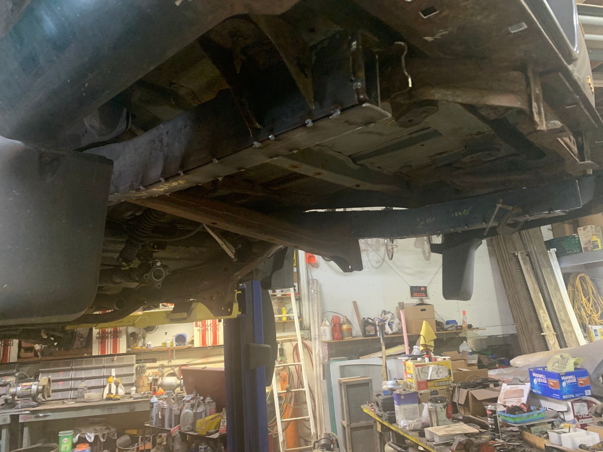

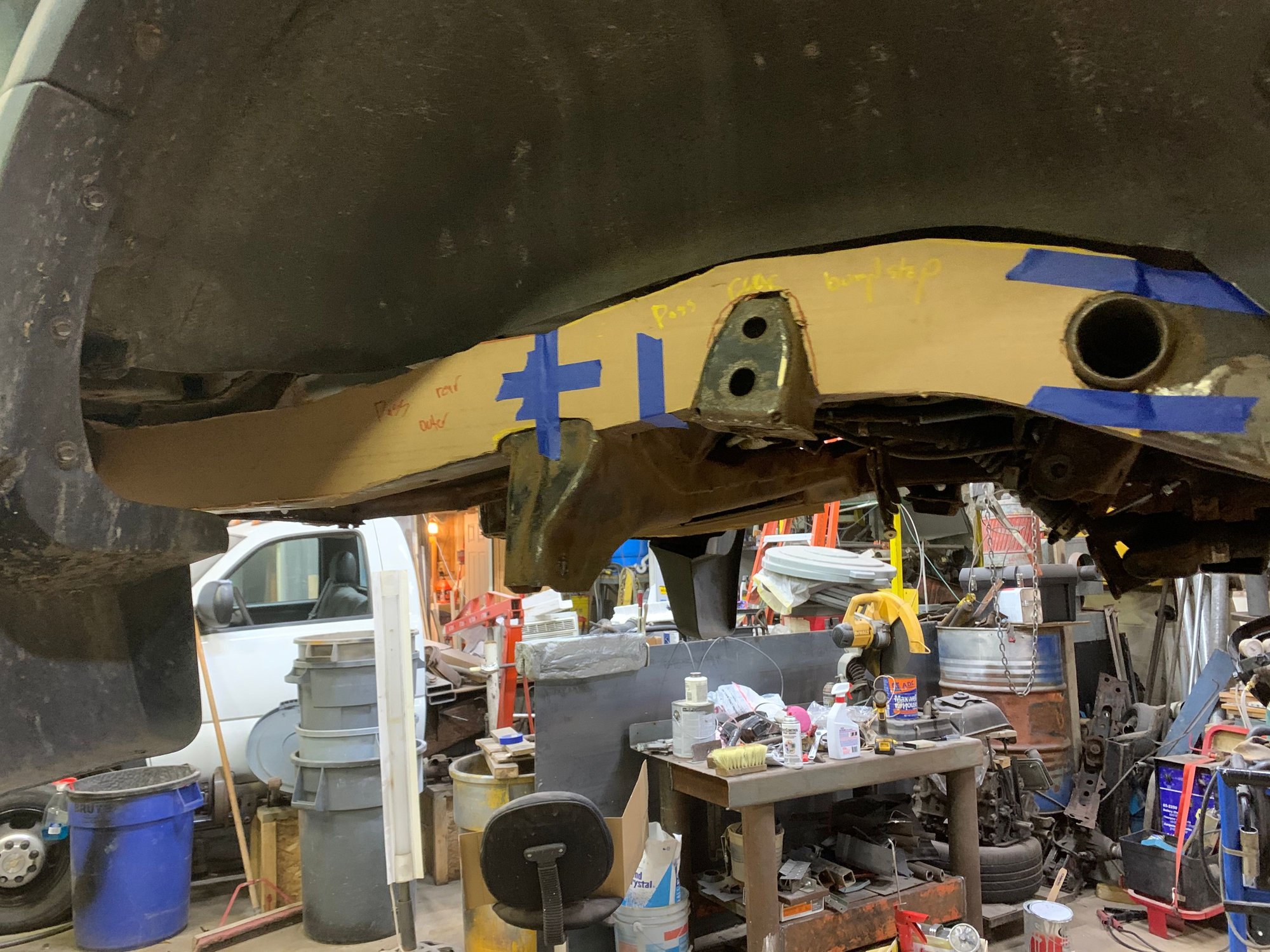

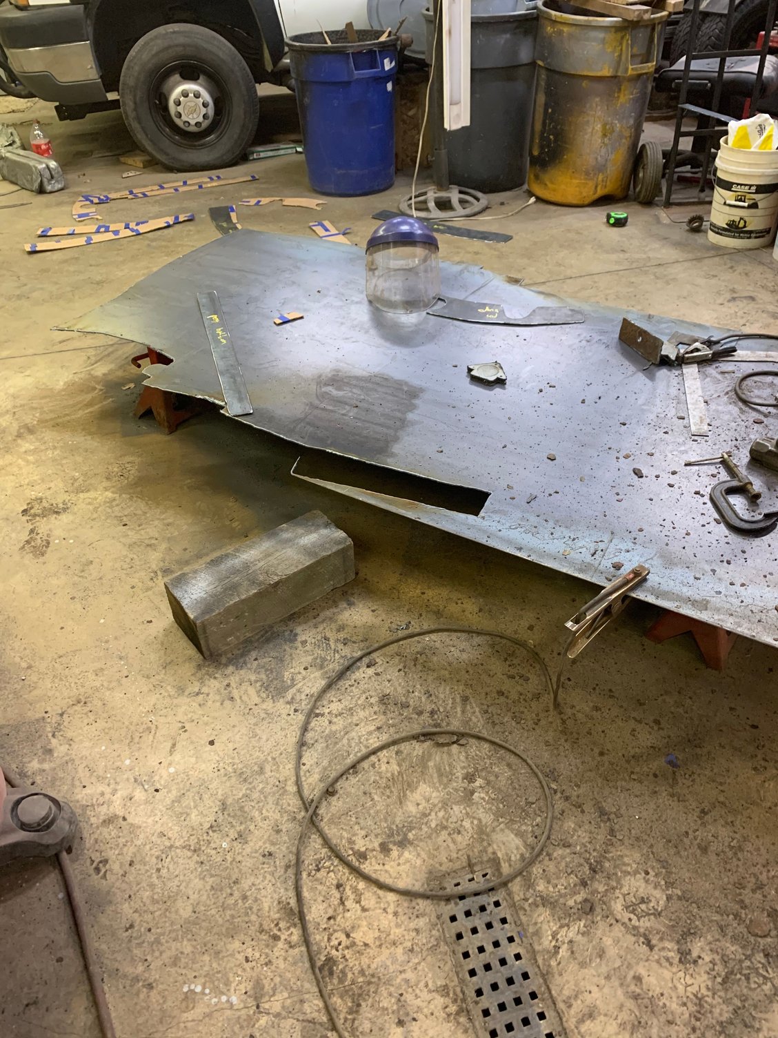

I’m back after a 2-3 week hiatus of not working on the 4runner. I was transitioning out of my old job and it was requiring all of my available time. But now I’m back to school I should have more time to devote to this. I got the rear frame ready for patches to go on and I am now in the process of making templates

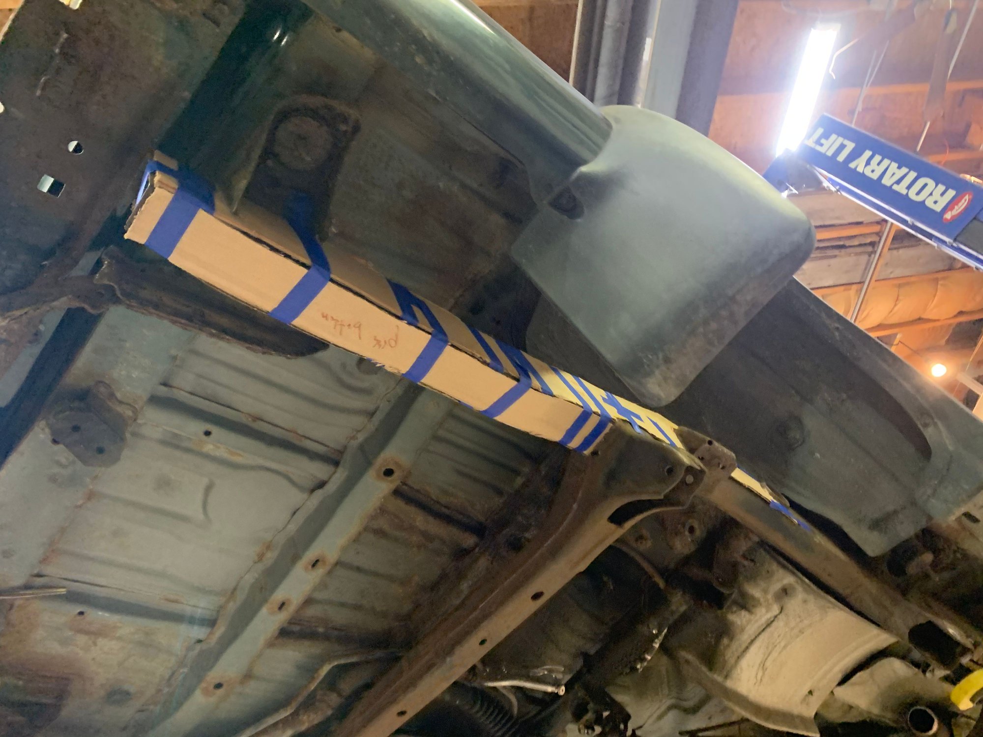

I have the rear 1/3 of the frame patches drawn up and measured. Now it’s time to start to transfer them to the metal

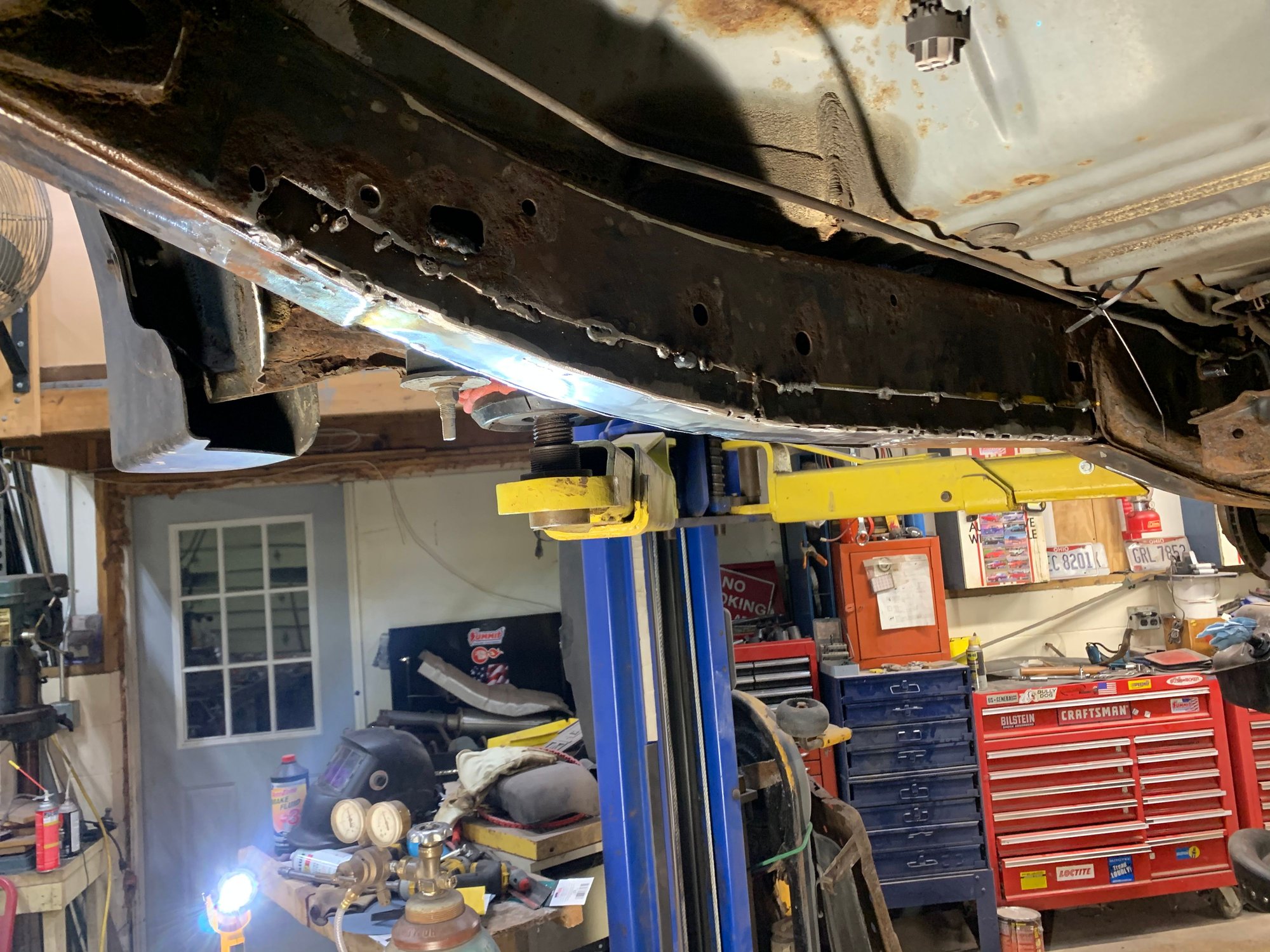

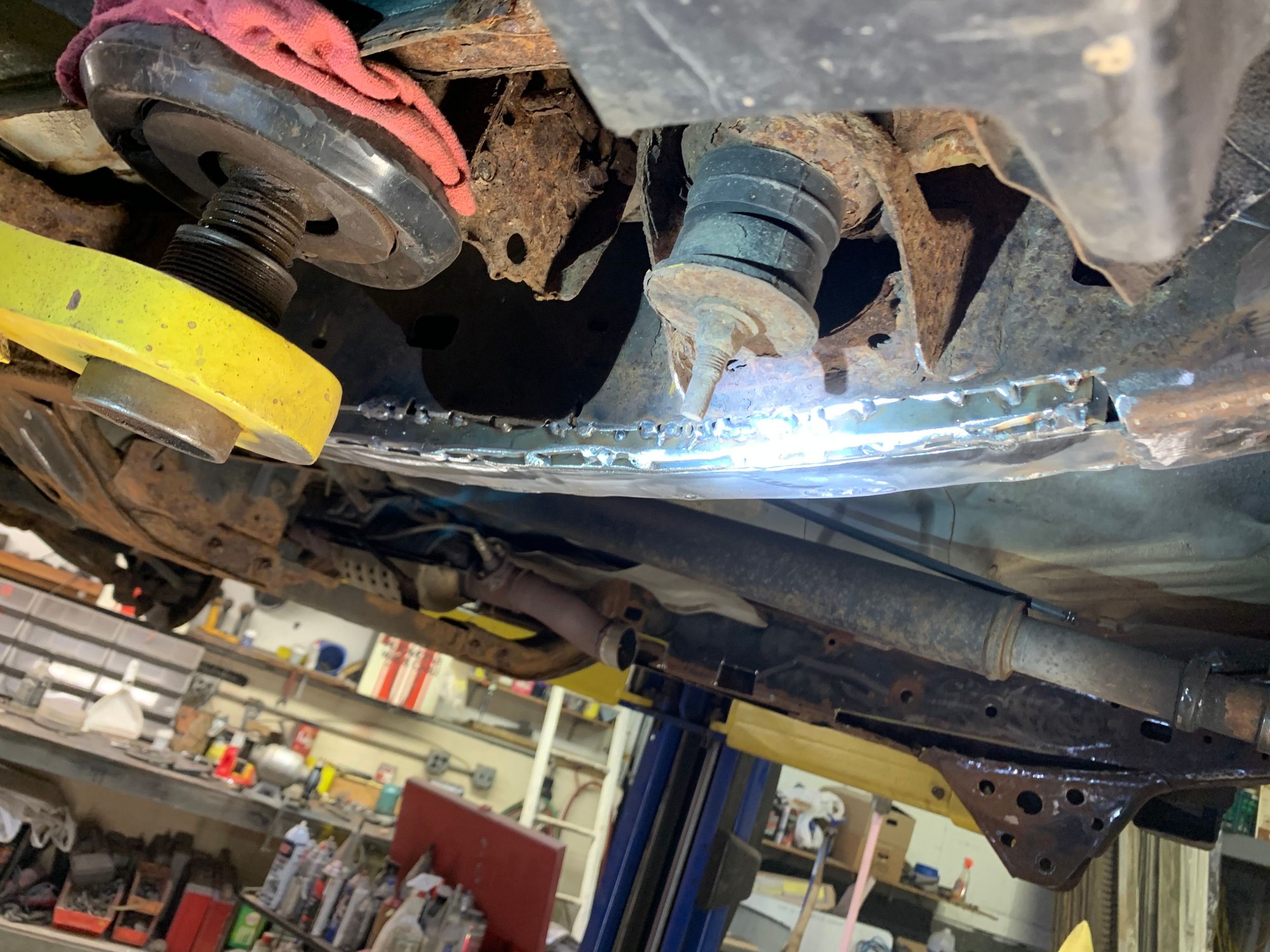

Got step one of the actual structural stuff done.

Actual step one I forgot to post

Sorry if my thread is a mess with just picture dumps. I will try to consolidate what the plans are as of right now.
frame: have over half of it done, front bad parts still need the outer skin welded on and coated. Rear is almost done and just needs stitch welded.
bumpers: still making the hybrid rear bumper out of the hitch, also am going to be cutting a tube and making a front light mount/push bar through my front factory bumper. Also am going to ad a front hitch in the center
lift: 2.5/2inch lift kit is coming in this week, already have my 285s on my stock trispokes, going to try to see what spacer I will need to run.
other mods: ordered a rear auburn locker yesterday, have a trd offroad decal coming in, need to figure out CB mounts, ORV flags and start to construct my on board air. I’d like to see if my factory AC is charged, if not that’s gonna be my compressor. If it does work I will need to rethink my idea. Also need to figure out the best way to do my dual battery’s.

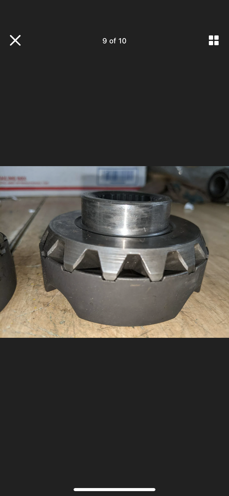

Score
Scored a lunchbox locker for about $100 off! Can’t beat that

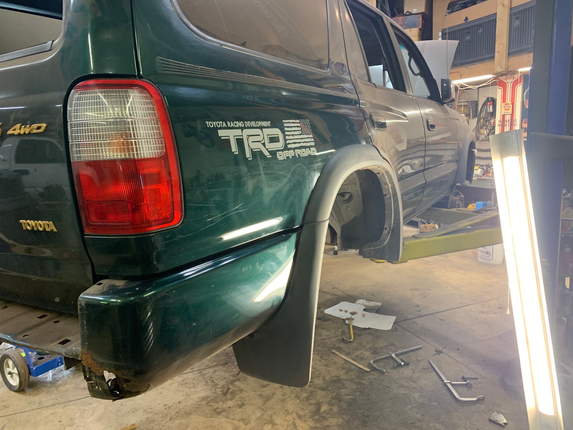

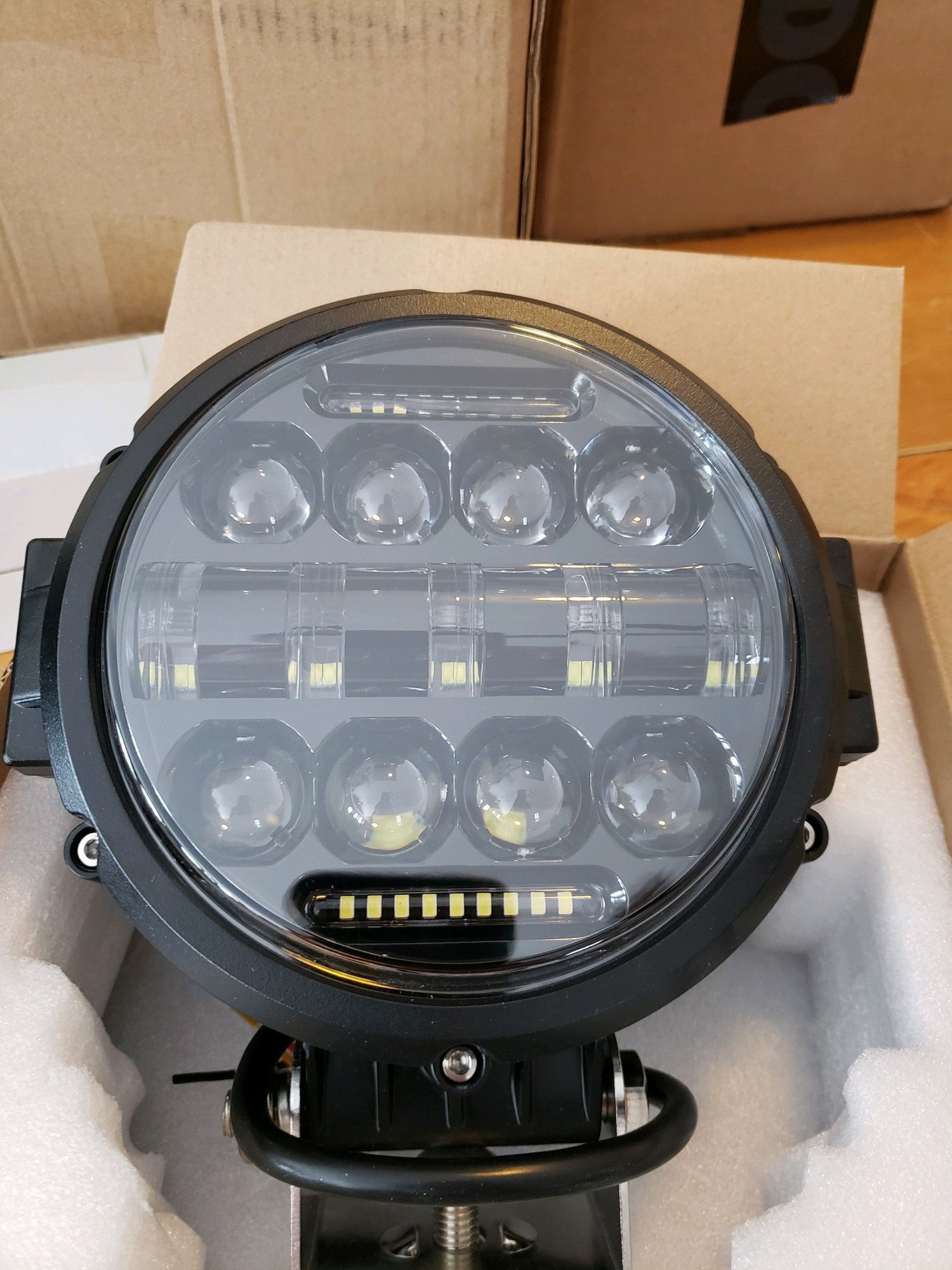

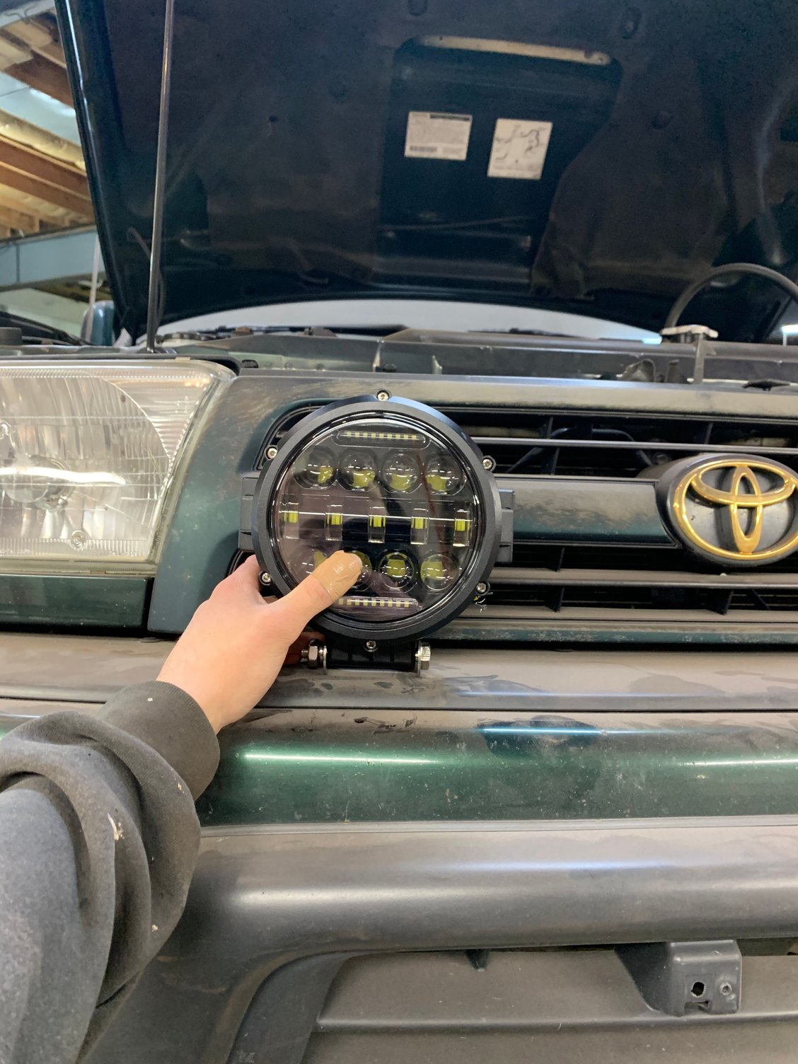

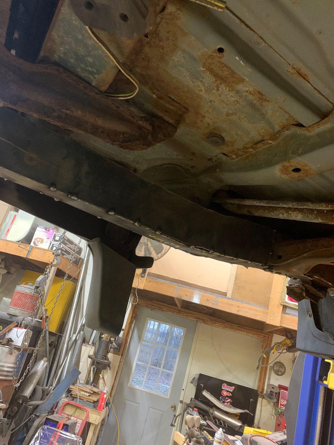

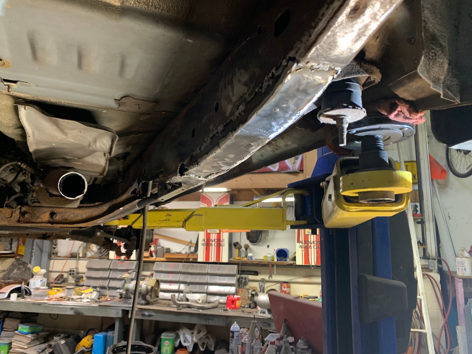

Got my TRD decal on the passenger side, also still been getting the frame ready for the exterior patches, have all the way to the back crossmember done, hopefully have up the the front and the rest of my sleeves cut by the end of next weekend. Slow going and can’t wait to get this done. Also test fit my lights
Placement for the lights and bullbar tubing
7inch LED light with integrated DRLs
Trd American flag decal, 1/8 inch crooked lol
Passenger primary patch
my lights

What lights are you using? I’ve wanted to upgrade my lighting for a while now.
Old Feb 15, 2021 | 07:37 AM
  #40
jaretstuff's Avatar
Joined: Nov 2013
Posts: 580
Likes: 28
From: Ohio
just some of the ebay “premium” 7inch ones. Were around $70-80
