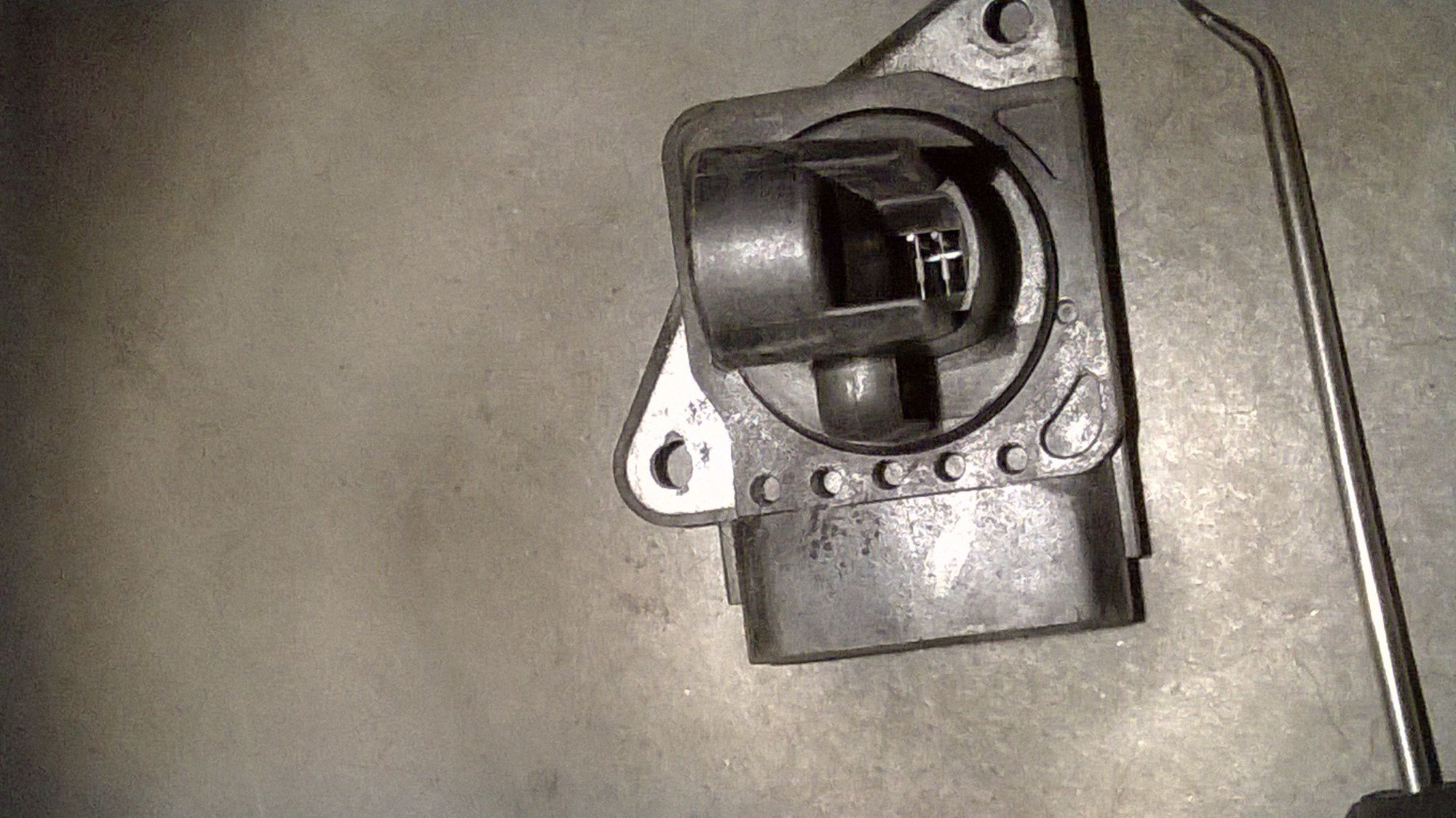

I did take a picture of the sensor:
It's not as bad as I was expecting, I didn't clean it up was no real carbon build up or anything.

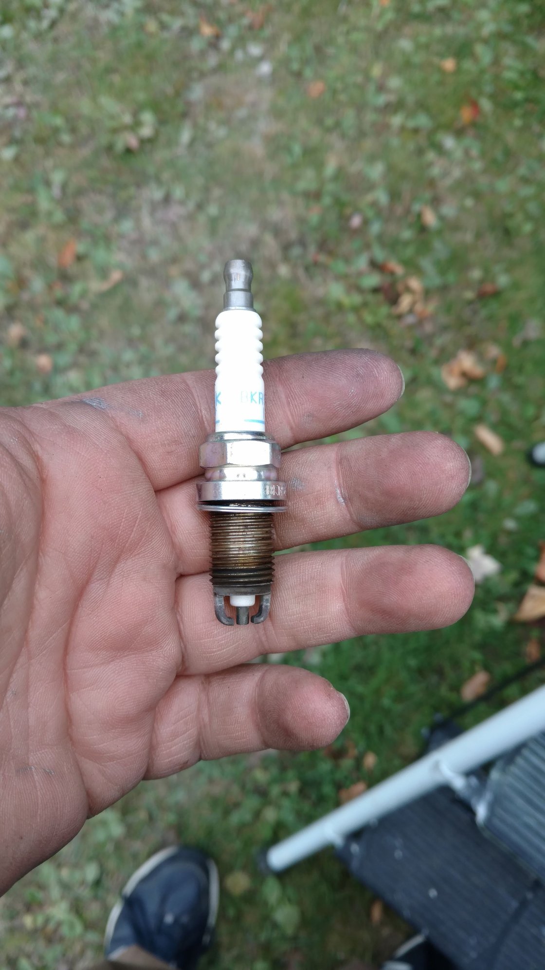

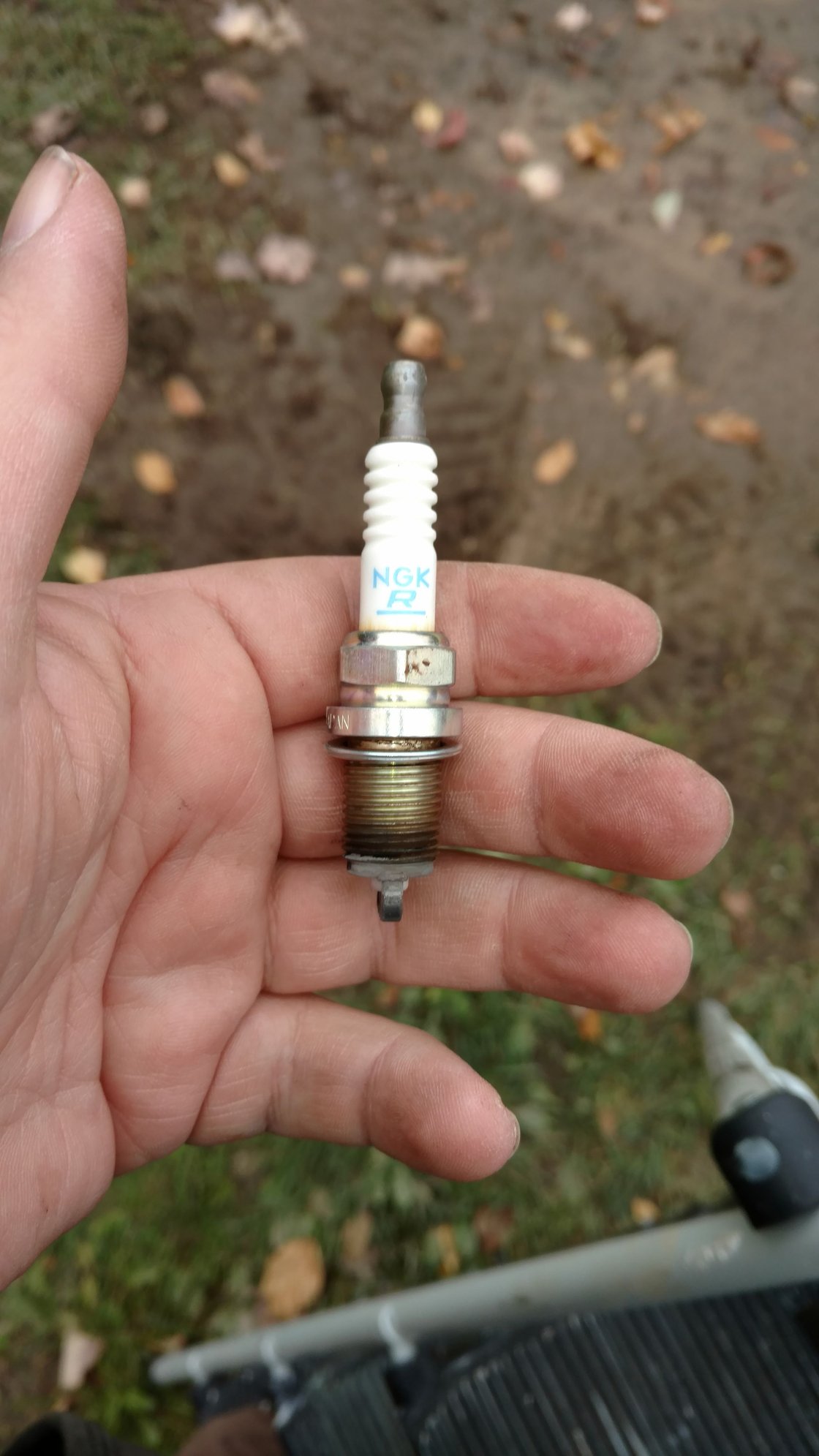

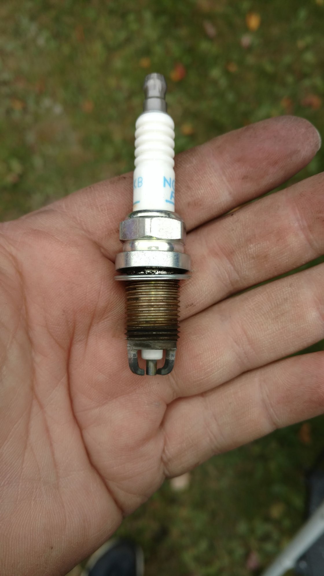

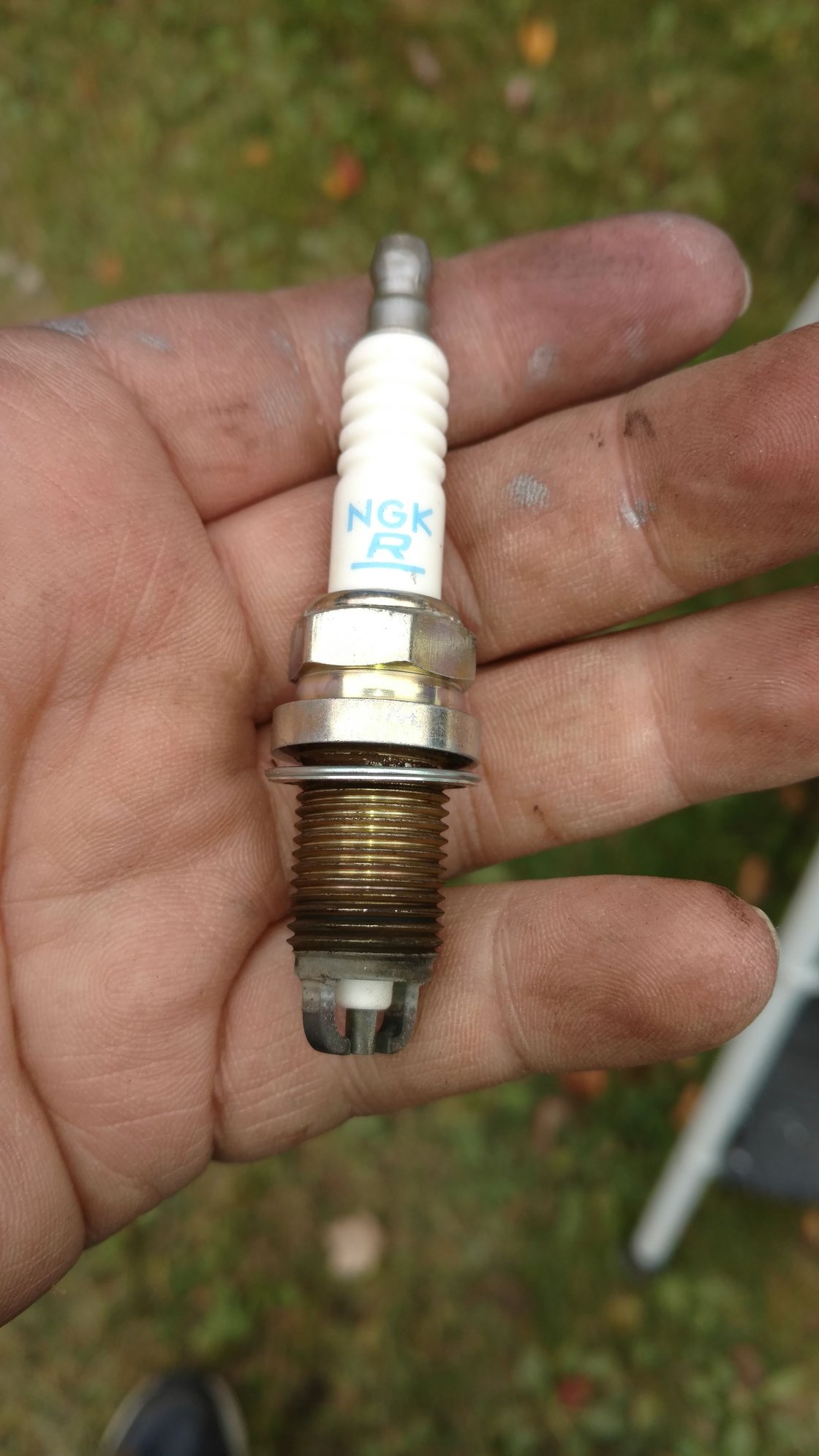

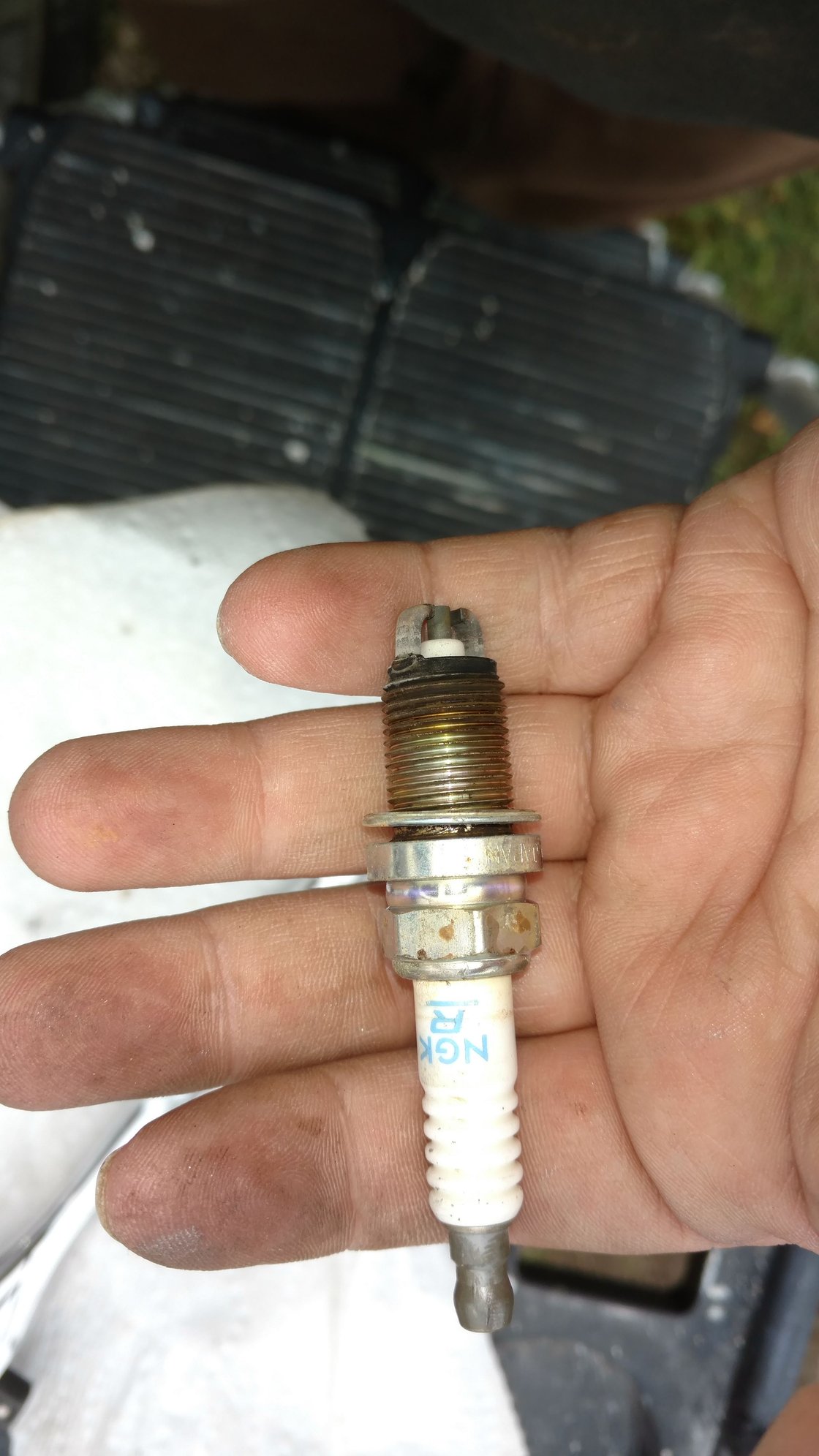

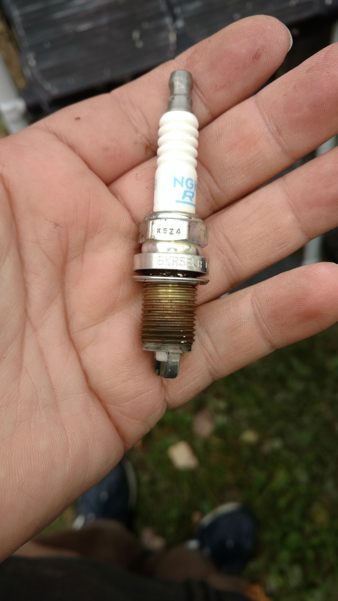

Changing the front O2 sensor hasn't stopped it from coding: P0172 on Bank 1; today when I went out and drove it about 30 km. So I pulled all the plugs and took photos:
Plug #1 (Driver Side)
Plug 1
Plug #2 (Driver Side)
Plug 2
Plug #3 (Driver Side) Plug 3
Plug #4 (Passenger Side)
Plug 4
Plug #5 (Passenger Side)
Plug #6 (Passenger Side)
Plug 6

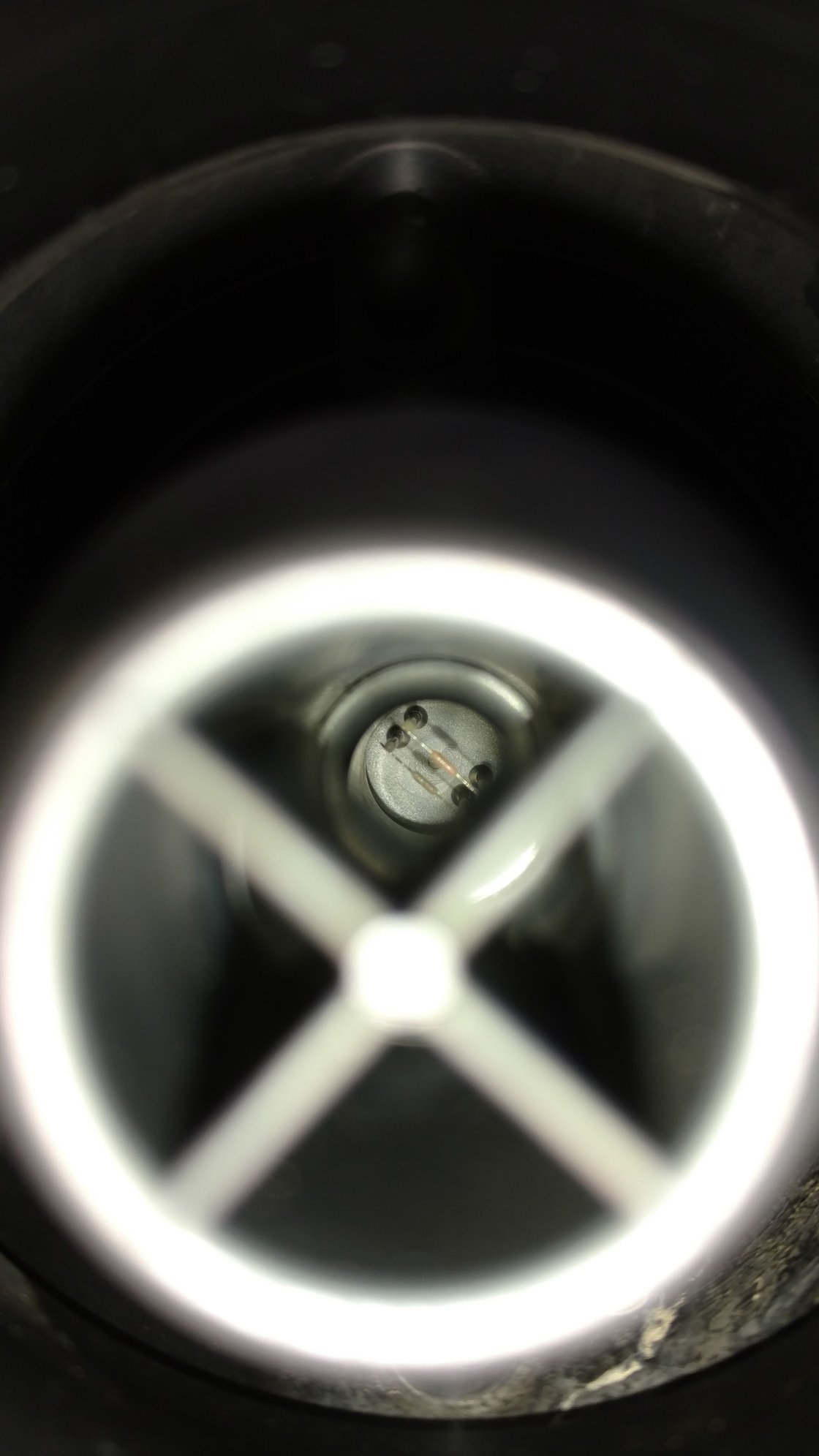

MAF Sensor:
MAF Sensor
No excess fuel smell and the plugs were bone dry. When I did start the engine after I put the plugs back in for the first time ever it acted like it was flooded and ran rough until I increased the RPM and after a few seconds it cleared. It continued to act a little bit flooded afterwards when you increase the to high RPM and let the RPM's drop there was a tiny bit of flooding for like maybe a second and then it would run smooth. It did that for about a minute after several ups and downs it cleared. Turned the engine off and restarted as normal no signs of flooding. I did the tail pipe test for running rich and the pipe was pretty clean not suit and nothing coming off the tail pipe.
I did some reading on the P0172 code it has thrown after the new O2 sensor and I've not seen anyone successful post a resolution to that code. I have also gotten P0125 insufficient coolant temperature for closed looped fuel control just before replacing the sensor (hasn't come back yet); in my reading that is also related to a faulty O2 sensor. And then there was the code for the exhaust pressure after I took the catalytic converter off (it hasn't come back since I reset it).
From what I read P0172 can be MAF sensor and and injectors as well. The MAF looks clean to me but this is a new area for me. The injectors and injector rail on the donor motor came with it and were never taken off to the best of my knowledge. Giving the low mileage on the donor motor what are the odds it is an injector issue?
I've not replaced the rear O2 sensor its still original to best of my knowledge.
Anyone with ideas with where to look next?
Last edited by Noil; Oct 15, 2017 at 06:40 PM. Reason: Fixed broken images from Photobucket

MAF is still dirty. Try using a pick tool to carefully take off the debris that is likely caked on.
P0172 isn't usually fixed by a new upstream sensor. .https://www.yotatech.com/forums/f16/...e-light-58613/
But a new upstream sensor will likely fix your cat issue.
Look forward to your successful fix!

Plugs look fine alright. Rear o2 sensor monitors the cat's functioning. Dont know how it works if you decide to keep it straight-piped.

I cleaned the MAF sensor really good and once dried out I put it back inline with the air intake. I noticed the throttle body assemble was scored pretty good on the backside of the baffle, didn't have anything I was comfortable using to clean it on hand, will be awhile before I can get some cleaner. I don't think that is related to the issue but more of preventive maintenance thing. One thing I noticed immediately was that the cold start idle time was greatly decreased. Before cleaning the MAF the high idle on cold start would be about 2 minutes today after cleaning the MAF cold start high idle was about 40 seconds and then the motor started to idle down. No codes on startup went for about a 30 km drive and still didn't throw any codes, so I think I am at the wait and see phase again. I have started sourcing parts from regional auto recycling places to do the MAF upgrade mod just in case the cleaning doesn't fix the issue. Worse case is I will have extra parts on hand to use in the future.
