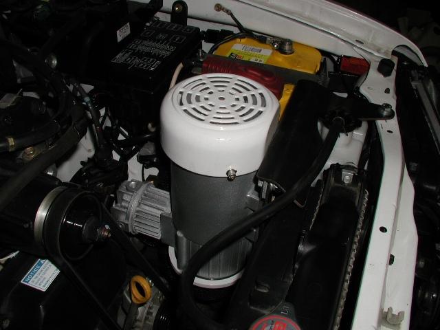

Here's a picture of an extremeaire mounted under the hood of a 3rd gen 4Runner.

Cool! any more info on that install?
(demanding little punk, ain't I?)
Thanks much... At least it lets me know where to look for space!

I have two questions. What happens to that thing when it gets water or mud in it?
also putting it in that location, will it work with a supercharger? Like is there enough room for both?

that install looks good, this will run lockers no problem, check out the manifolds made by slee, or,FRORF they'll help you plumb this thing out for tools, lockers, tires etc...cheap. i am putting mine in a tacoma and dont know wjere its going yet, may end up in my tool box in the bed, also this is suppose to be a completely sealed unit, check out the thread higher up for their web site, and also a short write up is higher as well, cant wait to get mine

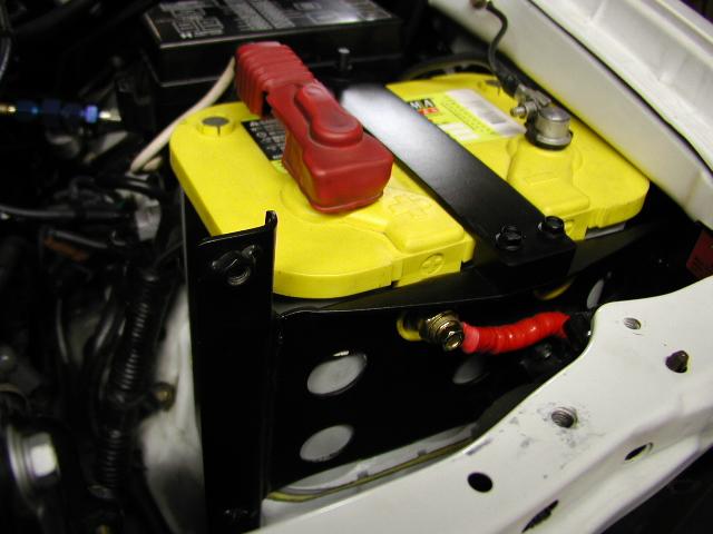

If you look closely at the compressor picture you can see the supercharger. The compressor is a sealed unit except for the intake which could be extended just like a differential breather. The bracket I made is a two piece system. One piece holds the compressor, that bracket is bolted to my battery bracket which is bolted to the vehicle. Here are some pics of the battery bracket.

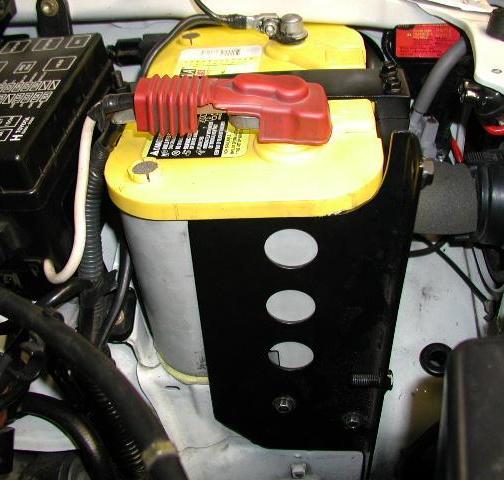

Here you can see the bracket is bolted to the body with two bolts under the battery and another bolt which you can't see is under the red box (h.i.d. igniter) in the upper right hand corner of the picture. You can also see the bolt and nut that is used to attach the compressor bracket to the battery bracket.

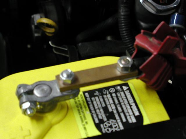

Here is a piece of copper that I used so the stock battery cable works with the yellow top.

That is a nice bracket. Would you happen to have that traced out so that others may copy what you have done, like me??

Gadget, I don't have it traced out but I might be able to send both brackets to you in a couple of weeks if you want to copy them. I need to warranty my battery so the bracket will be out of the vehicle and I won't be wheeling for a while anyways. One thing that I have noticed on other model years is the absence of the two factory tack welded nuts where the two bolts are in battery5.jpg so that may be a problem for some people but a work around would be fairly easy.
