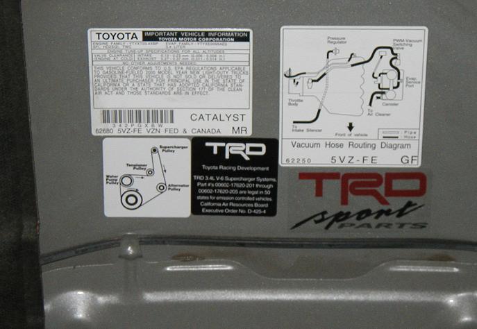

You know what's funny is, during dinner I was thinking of adding some thoughts to this thread.
You didn't sound harsh at all. I was just being dramatic because this keeps getting brought up. I was only teasing you. Jay has already looked at my setup, in person, and can't think of any reason why it would do the engine harm.
However, you say the Dealership says the boxes are "Pressure Dampeners". What's funny about that is on the Vacuum Routing diagram on the underside of my hood, it's called the "Intake Silencer". Hmmmm....
If you look at the pic below, posted by PhxTRDRunner, you can see what I'm talking about. Look closely at the Vacuum diagram on the right hand side of the pic. In the diagram, near the bottom left, you can just make out the text I am mentioning...
https://www.yotatech.com/attachment.php?postid=26879
I have run open intakes on my vehicles for over 20 years with no adverse effects. If you read my article, you should have seen the link to the counter-point articles on removing intake silencers/resonators. If you didn't read them, go back and check them out. They're excellent reading, but just remember every engine is different and not all things apply to all engines.
Just for fun, why don't you go out to your truck, pop the hood and take a look at your vacuum diagram. What does it say the FPR hose attaches to?
Please post back with your results!
Dr. Z
PS Thanks for the pic PhxTRDRunner! Your timing is most helpful!

Intake silencer mod
Hey Dr. Z,
I checked my vavcuum routing diagram, and i saw the intake silencer, but it isn't even named on mine, its just a black box with no name. Anyways, I am going to cap the ends of the holes and try it before i get a whole new pipe. I am usually pretty skeptical about new things, especially things that aren't really made to be changed, you know. Anyways, thank you, I will get back to you when I get the chance. By the way, were do you get filters for the deck plate mod. I just have small holes drilled in the front right now. just curious.
