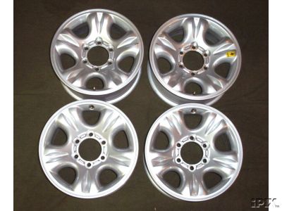

The ones I got are off a 2002 Sport Edition 4Runner. 16x7"
I haven't found the center caps but I'll probably not run them for a while.

Old May 2, 2003 | 08:14 AM
CTB's Avatar
CTB
Joined: May 2002
Posts: 1,218
From: SC
Nice. Those are some of my favorite rims that Toyota ever put on 4Runners. Are you planning on still using the caps on the front eventhough you have the Aisin's? Going to modify them a little to fit?
