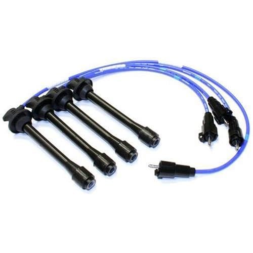

I just swapped my wires out on the 2.7 L today. I'm pretty sure they're the originals at 167k. They looked perfectly fine, but I'm trying to fix an idling problem, so I figured it was worth $42 to give it a shot (didn't fix it ). Anyway, now I've got a spare set of wires for an emergency I guess. I kind of like the new blue NGKs.
