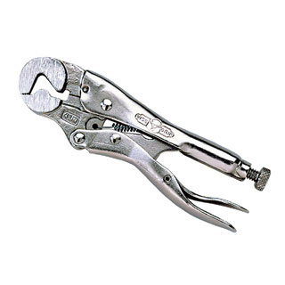

Have you done this job?
it took me half a day, including the fronts and a trip to the store for more brake fluid.
Dont forget these; just in case something bad happens.
Attached Thumbnails How to change the brake lines/hoses?-vice-grip.jpg   How to change the brake lines/hoses?-lighter.jpg
