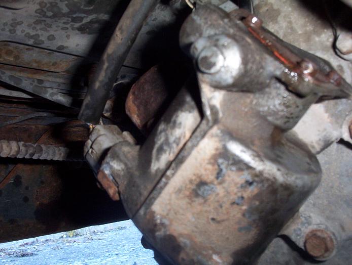

Actuator
How can you free up a sticky tranfer case actuator?-100_1402.jpg I have removed the plate on the actuator pictured here in the top right corner where you can see the orange gasket. Inside it is a cog with a hole in the middle of it where it looks like you could use a Torx socket, (except it is much finer, probably about 16 points) to turn the cog which is meshed with the shaft that engages the 4wd. If I could turn this cog, it would make the shaft engage and disengage possibly freeing up the actuator. (The plate must be there for some reason!!!) My questions is..... before turning the cog, do I have to remove the actuator motor on the other side? I am assuming I will because it has to be meshed with the shaft going to the cog!!!

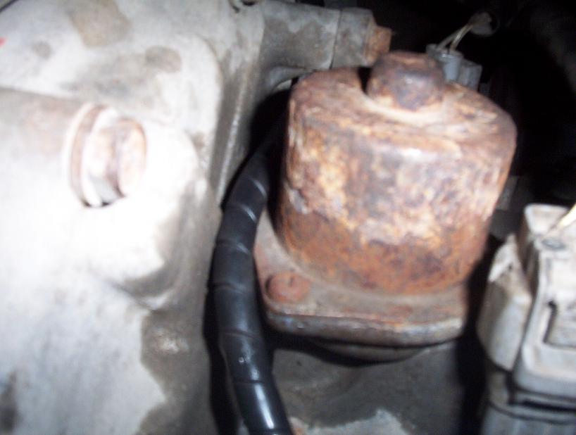

How can you free up a sticky tranfer case actuator?-100_1398.jpg Here is the actuator motor I think I need to remove..... What am I dealing with here, do I just take out the 3 screws and pull the motor off. There are no wires going to it so what makes this baby tick? I'm affraid to try and remove it in fear of not knowing what is inside it and how easy it will be to put back on!!! Any input on this would be greatly appreciated!!! Thanks!!!

That cap with no wires in it houses the magnets and a shaft bearing. The stator with the motor windings on it turns inside those magnets. If you pull the cap, the motor stator will stay in the main body of the actuator. The brushes for the motor (where the wires go to) are in the main body of the actuator, near the base of that cap. If you pull the cap off, you could check the magnets, clean out any gunk, free up that bearing and probably turn the stator to see what goes on through that other inspection plate you already have off. Another way to go about it could be to pull the vent hose and fill the thing with WD40 until it drips out, but this is sloppy, not long lasting, could cause another problem, and overall probably is not the best solution. At least you wouldn't have to take it apart. The actuator probably got water in it through that same vent hose.

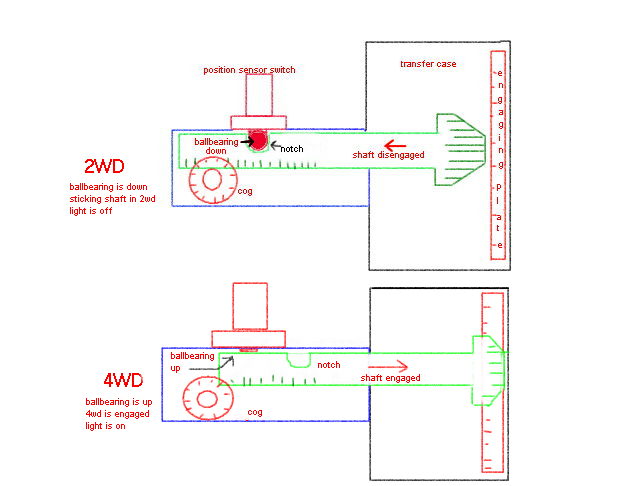

THEORY on the Position Sensor Switch and its workings!!
Beto, you sure know your stuff and it is greatly appreciated. I have a much better understanding of what I am about to tackle thanks to you. I am taking the day off work tomorrow so that I can tackle the project. I will definitely take some pictures of my progress and keep you informed on the outcome.
How can you free up a sticky tranfer case actuator?-actuator-shaft-theory.jpg I also plan on taking out the Postion Sensor Switch to make sure the ballbearing at the end isn't sticking. Here is a drawing that I completely made up....I don't even know if this is how it works... its just a theory I have...... does it seem to make sense. If the ballbearing is stuck extended all the way out, it wouldn't let the shaft move, the truck engage into 4wd or the dash light come on. (I have the notch in the shaft exaggerated to make my theory easier to understand... naturally the notch would be more like a dimple on the shaft). Take a look and see!!!

Makes sense to me but I really don't know exactly what's in there. I remember the cog on the end of the motor shaft engaging a worm gear - vaguely - this is opposite to the rear diff lock actuator which has the worm gear part on the motor shaft. As far as that ball bearing it could very well work like that. The one question I would have is how does the actuator know when to stop actuating when engaging 4WD? It would have to have some separate mechanism to remove power from the motor once it is fully engaged. It should be pretty logical in there, I don't think you are opening a can of worms unless you find something damaged, then you need to fabricate your own replacement part or replace the whole thing. The chances of it springing apart into a million unidentifiable pieces is very remote. If it were sort of working right now I'd be more cautious because you'd risk making it not work at all. That is not your situation, you either take it apart and make it work, or find out that it can't be repaired - either way you still haven't lost anything.
