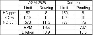

Good morning All,
thank you for all the suggestions.
Here are the readings from the test (there were only 3 items measured, aside from RPM and Dilution), please take a look at the attachment.
I did connect an OBD II reader and got no codes . I have cleaned my MAF sensor about a year and a half ago, but I remember it threw a code at me when it was "dirty" that time.
I have also spoken to one of the guys at the dealer, he suggested it might most likely be an O2 sensor that's down from the catalitic converter.
Best regards!
Possibly the one in front of the converter, but definately not after since that only checks the condition of the cat which is obviously working fine given the numbers you posted. Go through the list I mentioned and eliminate the items one by one.
