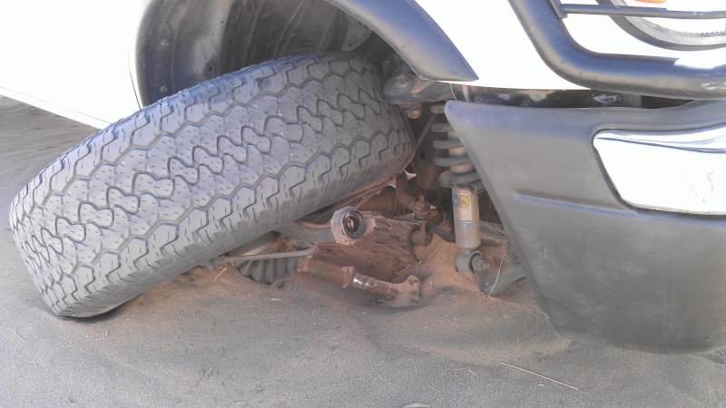

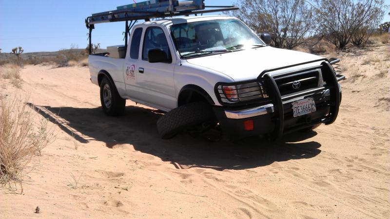

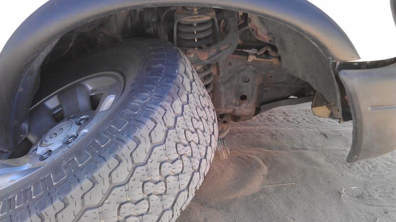

so on my way home from work today i had a surprise coming down my road, i hit the same 4inch bump i hit every day but today the usual bang was the hub and wheel folding under. Im very happy it happened here as opposed to anyother mile of the 20k plus miles i drive each year for living on dangerous high speed curvy mountain hwy's and free ways. I really happy the truck is just inconveniently parked down the street from my house, i can only imagine myself being wadded up at the bottom of a 100 foot canyon after flying off a particular unprotected compound curve the the free-way I commute on every day that btw has a good hard bump leading into it at the bottom of a hill with a 65 mph speed limit, I doubt control would have been an option i would only have been an observer and the first at the scene of the accident too boot.
the failure is obvious the ball joints cant take the extra stress of bouncing around with all my tools and gear everyday for thousands of miles week after week
I need a solution that a working man can afford,
i have been looking at SPC Adjustable Upper Control Arms for some time because i have a laod related out of range negative camber problem that causes the tires to where heavy and fast on the inside, but i dont know if they are any stronger than stock uppers, but they would solve my tire consumption problem
I have yet to run across a solution for the lowers, does anyone know if a more bomb proof lower exists for my truck?

Your ball joint went out, then the flopping tire destroyed your CV. Your hub looks fine.
You really need better spings that can carry more weight, front and rear. I don't know what your trying to accomplish with updated control arms, nor that it would matter.
Get OEM ball joints and CV's and remember to check them often...
Let me ask you...if you know the hole is there, why hit it?

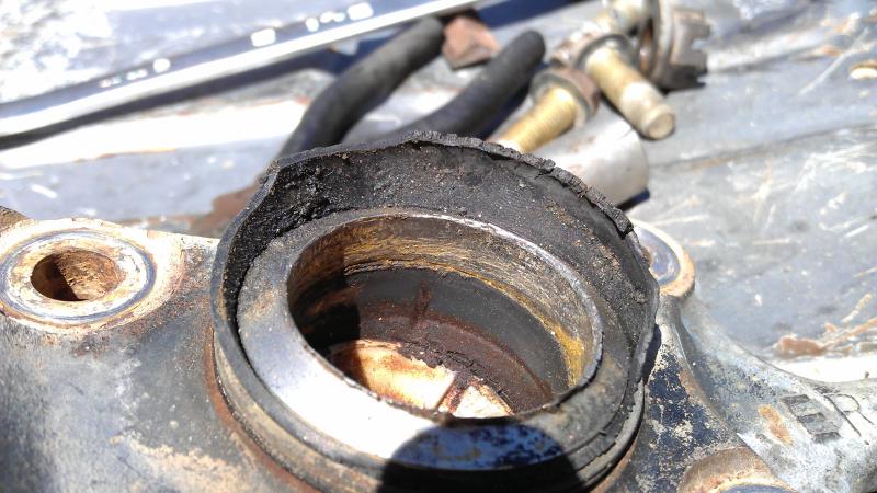

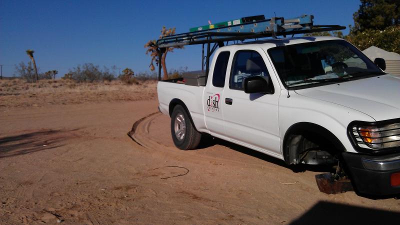

so last night I jacked up my truck, chained a pice of an old water heater tank under the control arm, locked up the rear and skid it home, so now that its all apart, i can clearly see that the lower ball joint failed because it dried out, which caused the gauling and pull thru, the left side joint is fully intact with no end play that i can detect, and its still fully wet, lesson learned any sign of grese leaking around a these ball joints Replace them right away or suffer!!!!!!!!!!!!
really don't be stupid like me, go check your ball joints right now and see if they are dry!!!!!!! its a bad deal when this happens because wheel and hun folds under the frame and jams becoming a skid, while firmly holding the tie rod, making it impossible to steer the other wheel, and did i mention it tears the brake hose off so the breaks fail completely as well? you would have only the e-brake for comfort and if you live in a wet climate its probably frozen too
so im replacing all 4 ball joints, both cv shafts, both front hub bearings bearings because now is a good opportunity, I noticed when i pulled the cv shafts there was heavy weight oil/grease on everything which should not be there unless the bearing seals have been compromised. guess i get those SPC control arms later. they are a very pricey upg and $250 per side

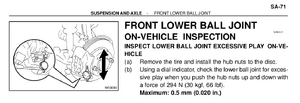

That's the wrong way to do it. That's why there are service manuals, and professionally trained mechanics. The LBJ's are spec'ed for 0.02" maximum play. You'll never see that with the naked eye.

It is not only possible, the proper procedure is explicitly explained in the service manual.
