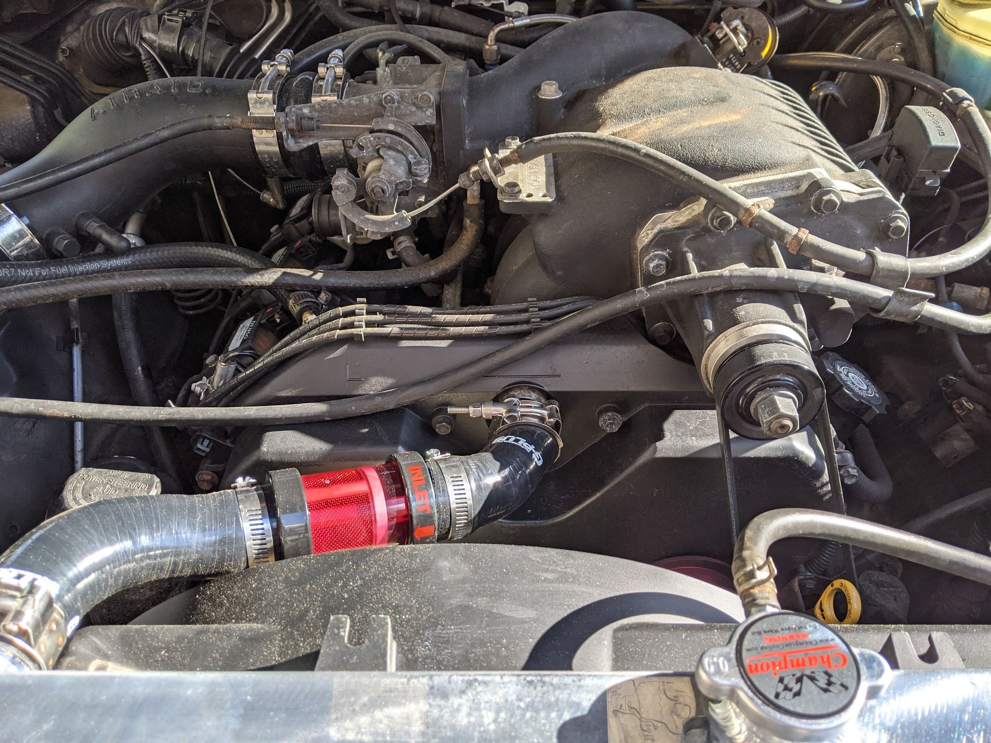

I started tearing her apart today. My aim is to do the timing belt, front seals, water pump, thermostat, radiator....

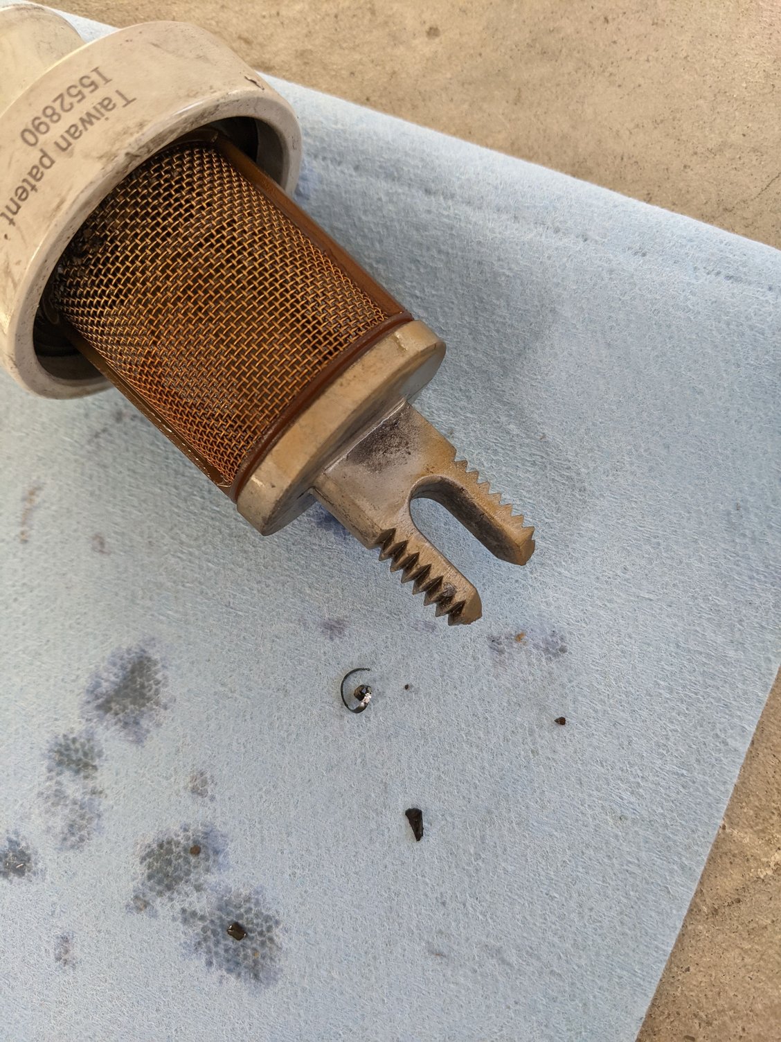

I installed one of those coolant filters in the upper hose and found a small amount of metallic debris with a curly-q. Not sure if that has been there forever or maybe part of the water pump? Time will tell (maybe)

Finally got everything done and back together today. Runs just as she did before. I killed my ac idler by degreasing the front frame / engine, my dipstick o ring was mia. I never found anything exciting, the water pump looked great and I could maybe convince that it had had a little play in the shaft...
I hooked up my obd scanner and noticed ect 190-203 on my drive with hills and a little boost on the highway. I think it is a little high from what I have read? Maybe not with a supercharger?
